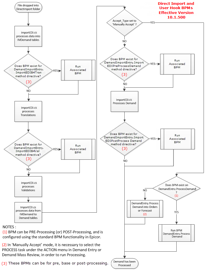

The method directives used in Import EDI Demand processing are as follows:
  • ImportEDIb4tran - If it exists, the Import EDI Demand Process runs the custom BPM code you associate with this method directive to manipulate inbound EDI data stored in Intermediate Demand tables before the ImportEDI routine runs and processes translations on the data.
  • ImportEDIb4val - If it exists, the Import EDI Demand Process runs the custom BPM code you associate with this method directive to manipulate translated inbound EDI data stored in Intermediate Demand tables before the ImportEDI routine runs and performs validations on the data.
  • ImportEDIpreProcessDemand - If it exists, the Import EDI Demand Process runs the custom BPM code you associate with this method directive to manipulate validated inbound EDI data stored in the regular Demand tables before the ImportEDI routine processes the demand data into actual sales orders or forecasts.
  • ImportEDIpostProcessDemand - If it exists, the Import EDI Demand Process runs the custom BPM code you associate with this method directive to manipulate inbound EDI data after the ImportEDI routine processes the demand data into actual sales orders or forecasts.
  • ImportEDIonUDImport - If it exists, the Import EDI Demand Process runs the custom BPM code you associate with this method directive when more than 95 User Defined (UD) fields exist on an inbound EDI transaction map you are importing. The ImportEDIonUDImport method directive is only available in Release 10.1.400.12 and above.
