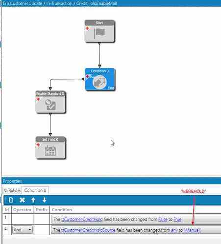

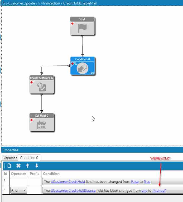

Here is the screen shot of the Data Directive that is working in TEST. I have the same in LIVE, except the manual is replaced with “WEREHOLD” The Set Field 0 is setting Customer.CreditHold = false .
