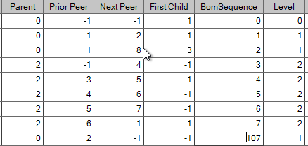

There is only one issue with the record. I think… The BomSequence doesnt seem to follow the pattern of the existing Assemblies.
is it a problem?? I thought it would be 8.

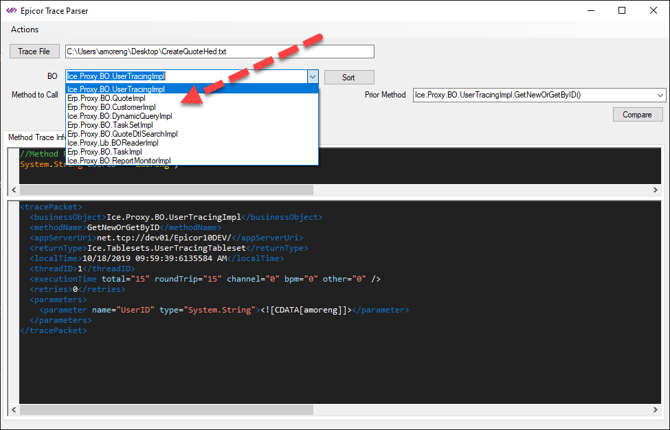

Best practice is to follow the calls found in the trace. Sometimes, seemingly innocuous calls are actually vital in setting different fields properly within the dataset prior to updating. I am not familiar with Job Entry or really anything related to this business object, but I can tell you that you’ll have the best luck by recreating what you see in the trace.
There is a nice tool that @josecgomez and @jgiese.wci built GitHub - jose-josh-do-dev/EpicorTraceDiffer: Allows you to Parse and process Epicor Trace Files Easily. which is great for interpreting trace logs more clearly.
