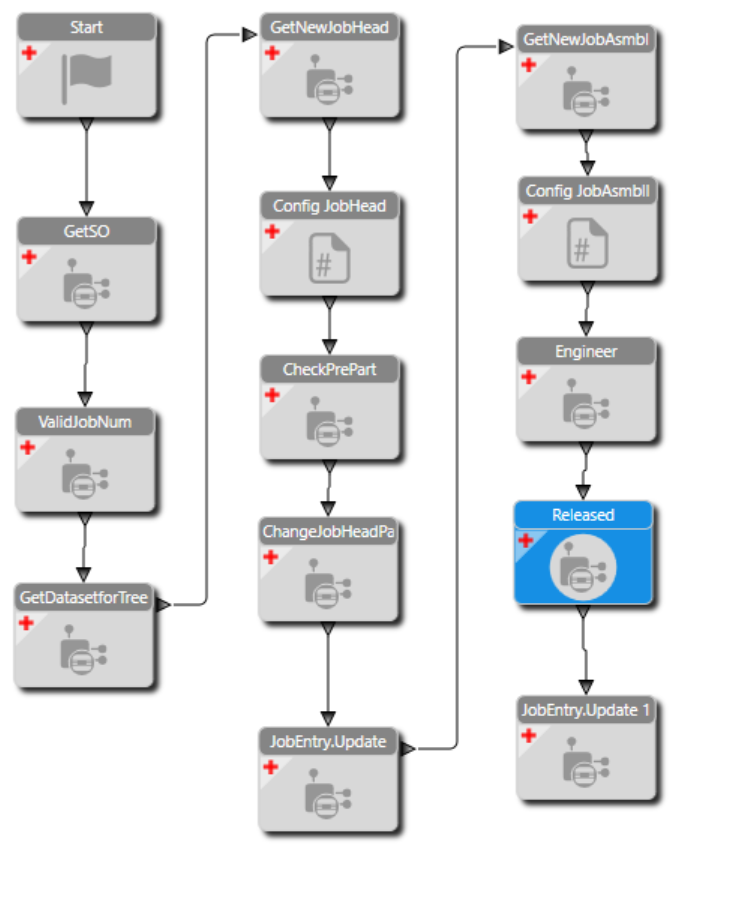

I am getting this error after calling after calling GetNewJobAsmbl
A valid Parent Assembly is required.

I am currently passing the following value in code, should ParentAssemblySeq be something else? I also tried -1 but same error
jobDs.JobHead[0].JobEngineered = true;
jobDs.JobHead[0].JobFirm = true;
I’d mimic whatever the existing JobAsmbl records look like.
Though, running a quick trace myself, I don’t see an explicit call to create a JobAsmbl record. I do see ChangeJobHeadPartNum() called right before the first update and thereabouts the top level assembly appears by itself. JobEntry has a fair number of helper methods that aid in populating defaults, rather than forcing you to construct the job table-by-table and line-by-line.

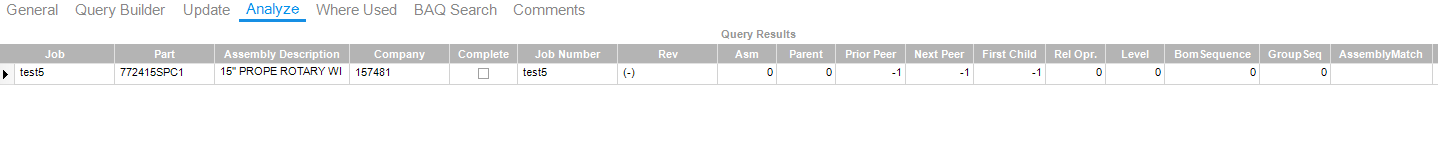

I wrote a query to compare to a new job that was manually created, but I still see the ParentAssemblySeq
@gpayne That’s what I saw too. The system calls Update after ChangeJobHeadPartNum and then the trace shows the top level JobAsmbl record before I even call GetDetails.

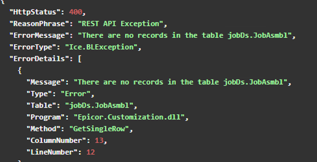

And that creates a new job with an empty Assembly but i am not seeing anything in the trace log that creates the actuall assembly and all my function calls create a job with no assembly, and therefore does not allow me to getJobProd
The first instance of JobAsmbl in this trace is in the method GetDataSetForTree, but even calling that is not Creating anything.
I tried calling GetNewAssmbly and it keeps screeming about valid parent sequence.

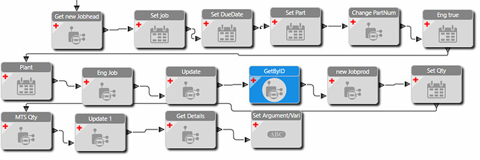

I have not done many functions, so I decided to do some for this. I accidently left out the GetByID in my first pass and got this JobAssmbl error.
All widgets no code.

I made three that make a job and get details two that get the date, quantity and part from the OrderRel data. One does a make direct and one does a make to stock.
