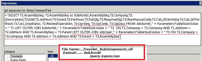

And have you already tried editing the query expressions for datasets in your existing reports? Depending on tables/fields needed, I might use this approach too.

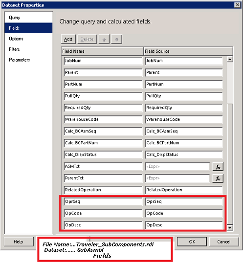

Screen shots below from Traveler_SubComponents.rdl where I pulled some data from the JobOper table.

In your example, you added the JobOper table to the reports query expression. Is that table in the original RDD? Or did you have to make a new RDD, add, and link the JobOper table?
I can’t imagine that just adding things to the report’s query, would cause the data set to be generated for them.
Yes, that might be a bad example
I was just reusing the JobOper table that was already referenced in the JobTrav RDD
  • pulled in into an existing subreport rather than adding a new subreport.
