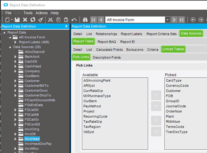

I recommend always checking the Linked Tables before trying to add additional tables. A good portion of the time the data you need can be found there.

@asmar , you can get the CustCnt as a Linked Table off of the InvcDtl table. Then you could add the CustCnt table to the RDD and join that to another table (InvcHead, Customer, CustomerShipTo, etc.).
That should get you what you need.
Thank you John for your great suggestion. I was able to fine the link, and included link/table does list the key column(s) for the email address of the contact. I am testing this now.
I included the missing columns. Unfortunately, the included previous columns and newly selected return a null value. Also, I am not sure why, but the CustCnt table has more than one row for the selected invoice/customer. So any Invoiced line relationship is going to be a one to many.
