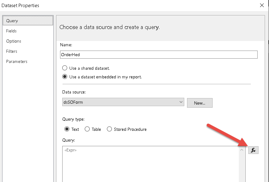

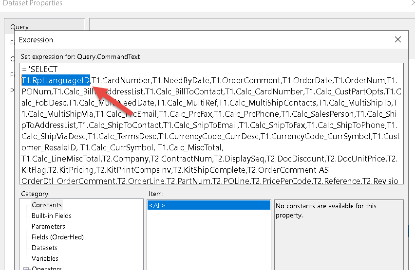

Note - In report builder, there are two places to add or remove the fields. In the UI there is the DataSet - that is a list of field objects that can be put into the layout. There is also an underlying query for the DataSet - you will also need to remove the field from the SQL that is used to pull the data into that DataSet object.
Hope this helps.
Thanks, I didn’t know how to find that text-based SQL entry screen. That worked. Deleting all references to MtExtPrice fixed the report. :smiley:
