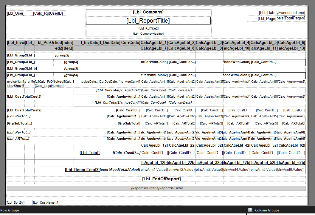

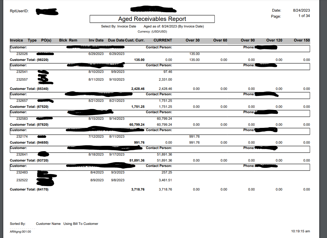

Hello everyone! I’m new to SSRS, and I’m trying to figure out how to go about editing this report. Essentialy this is the AR Aged Invoices report, and currently the issue is that it has multiple customers on each page, when we want a report style where we can have each customer on their own page. I have a copy of the style made and downloaded…I’m just confused by all the data showing that I’m not sure how to insert a page break between the customers.
Here is the SSRS report in report builder…
Here is the current print preview of the report…

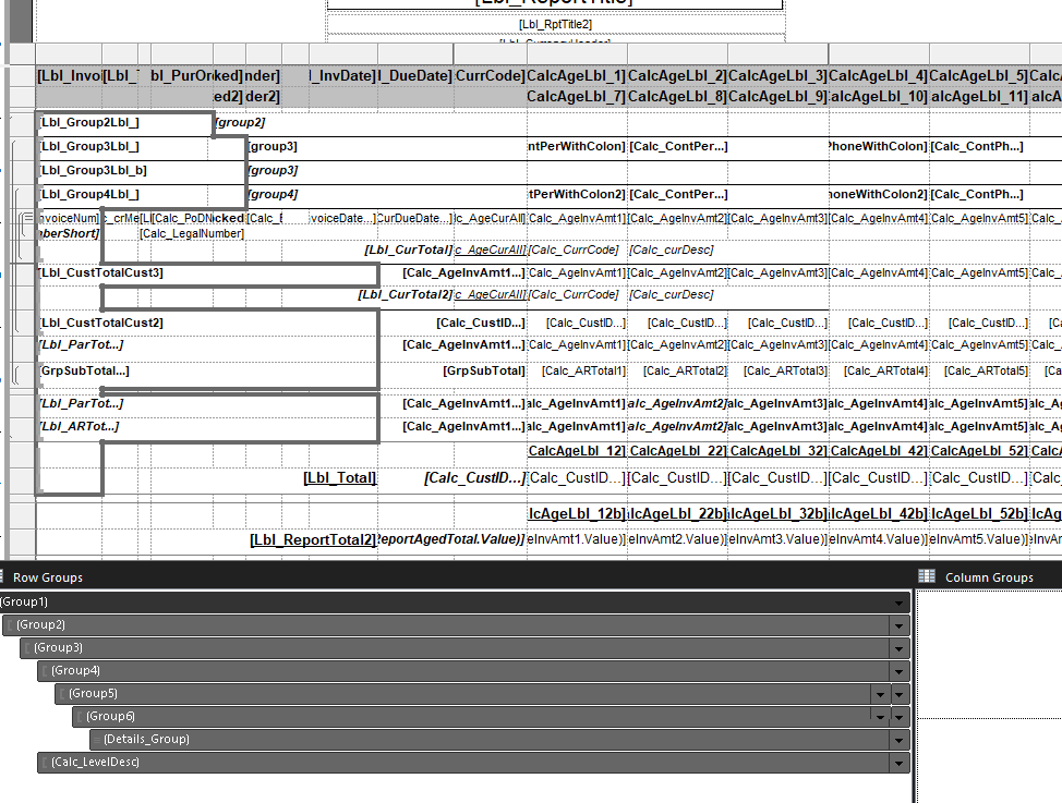

I would start by looking down at the row groups which should be arranged in a logical hierarchy. One should be for the customers. Right click on it, go to properties. Then there should be a Page Breaks tab. Select the check box to break between instances of the group. If you’re lucky this is all you need to do.

I believe it is Group1 that you want to put the page break on. Right Click on the group in the Row Groups and select Group Properties. Select Page Breaks on the left and check off Between each instance of a group.
Let me know if that did not work.

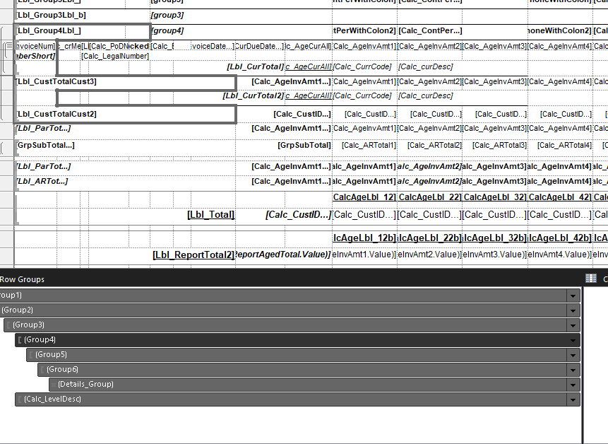

I tried adding to group one and group 4…but the report doesn’t look any different when I run it

Turns out it was because I needed to apply it to group 4 and every group above it for some reason, while leaving group 5 and 6 alone. Thanks everyone it works perfectly now! Glad it wasn’t super difficult.
