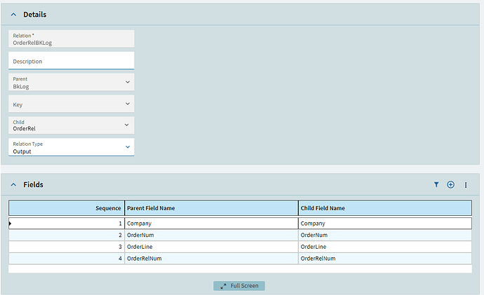

Relationship created between: BKlog and OrderRel
Relationship created on: Company, OrderNum, OrderLine, and OrderRel

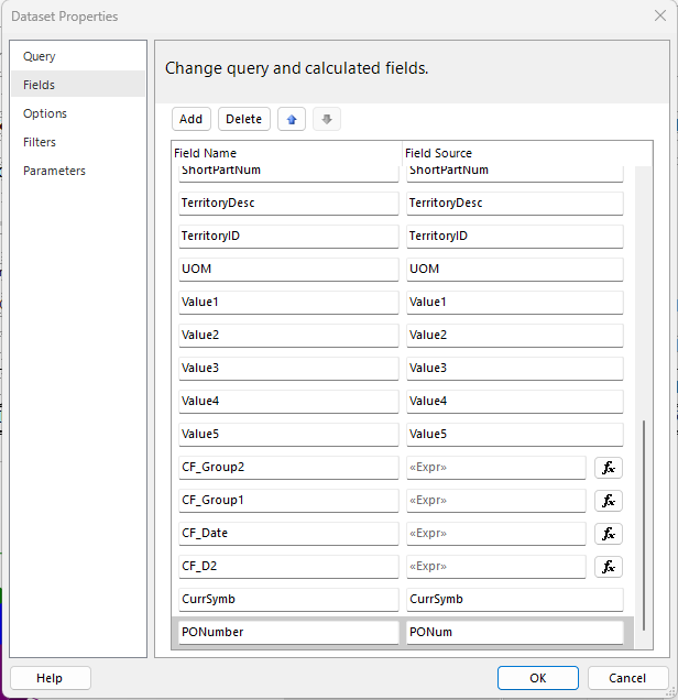

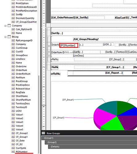

In my screenshot you can see where I tried to add PONumber under the bklog dataset. I still do not see an OrderRel dataset so I added it as OrderRel.PONum. I also tried adding it to one of the lines as you can see on the actual report. I’m not getting anywhere though, the report is coming out unchanged when I try to preview the custom report. Anything I’m obviously doing wrong?
One thing I’m failing to understand is why the report in Report Builder doesn’t look the same as the report when it prints.

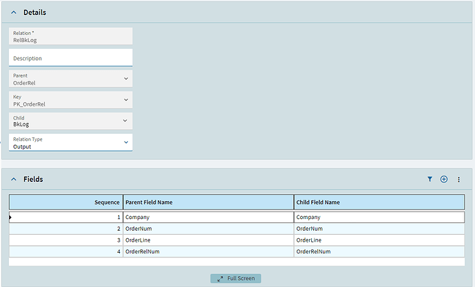

You need to make BkLog the parent table and OrderRel the child. Also, do not select a Key.
So, the first time I made this it disappeared and wouldn’t let me add relationships. Second time it’s now letting me. Do I want it to be setup as Output? And anyway you could explain why the parent/child matters?

Yes, you want output.
The BkLog is the main table that is being returned, so you want that to be the parent to restrict the OrderRel to only relevant records. Otherwise, you will pull back every OrderRel record in the table before even going to the BkLog.

Thanks for all that info. I think I was able to ensure that all of the quotations are good and normal. So basically, I’ve changed all of the stuff within Epicor and I’ve been told that I’ve done it correctly. Now in report builder I’ve edited the query and added the PONum field, I also went ahead and tried adding the PONumber to the report just to see if I can get it to spit it out (still getting errors).
Is that all I’m supposed to do? Does sequence of the relationships in Epicor matter at all here? Adding pictures in case anyone would like to look and see if I’ve made a mistake.

Also, I am not sure if it matters, but I always make my Field Name the same as my Field Source. Change PONumber to PONum.
I caught that as well. I went ahead and changed the field name. I took out the added fields to the report just to see what happens and I’m still getting a failed query execution in regards to BKLog.

If you are going to use fields in joins in the SSRS .rld, they must be present in the RDD as well.
I believe I have that set up correctly. Joining on Company and OrderNum.
Now just make sure that the fields in both of those tables are not “excluded” in that very same screen you have up. Go to Table fields exclusions and make sure both company and ordernum are not excluded from those same two tables.
