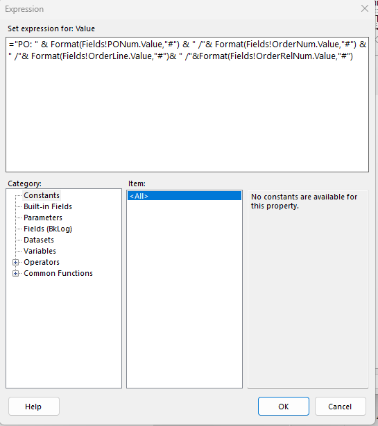

When I am trying to pull the PONum into the report it is remaining blank. You can see here it’s the first item I’ve added in the expression, am I doing something wrong?
Hi,
If you need to add OrderRel.PONum, you will need to add OrderRel as T3 table in the BKLog dataset. Properly do the left join with T1, and in your select clause, please add T3.PONum. Then you will see the desired result.
Hi yluo, instead of the OrderRel table I decided to use the OrderHed table. Are you saying OrderHed won’t work? Thanks for the reply!
Hi Jeren,
In OrderHed, the PONum refers to the customer’s PO number, not yours. The PONum in OrderRel table is the your purchase order number to fullfill your demand.
I am not sure which PONum is the one you want, hope it helps.
I looked into it and did want to use the OrderHed table. I was able to get it working. My issue was I was trying to add it to the report like this ‘Format(Fields!OrderNum.Value,“#”)’ and was only getting “#” in my report. I added it with this syntax and it worked ‘=Fields!PONum.Value’, not sure exactly why it wouldn’t work the first way, but I’m happy to have gotten it working. Thanks for chipping in to help yluo.
And thank you everyone that chimed in here. You all were very helpful in making sure I was doing this correctly.
