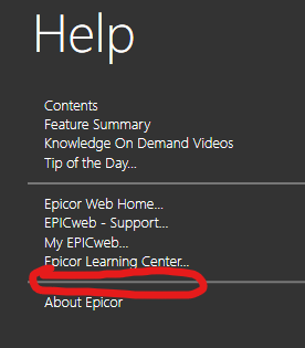

I just refreshed our training database using Epicor’s instructions. All is good except the link for ‘Education Courses…’ is missing from the help section.
How do I get that back?

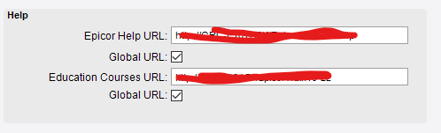

Nevermind. I needed to add in the urls on the company maintenance form under help.
Then the link appeared.
