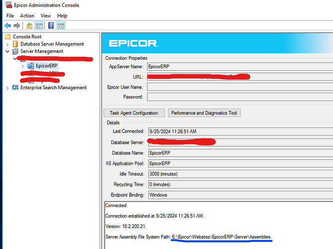

We want to set up an EI for AP payment. Anyone know where the file Erp\EI\Payment_Generic\Payment_Generic.cs saved? It is really appreciated if you can tell us.

It is on the server under the appserver folder then Erp\EI\Payment_Generic, but unless you need to customize that you can just setup the EI and pick it from the dropdown.
I cannot find this folder and file that you mentioned! Epicor 10

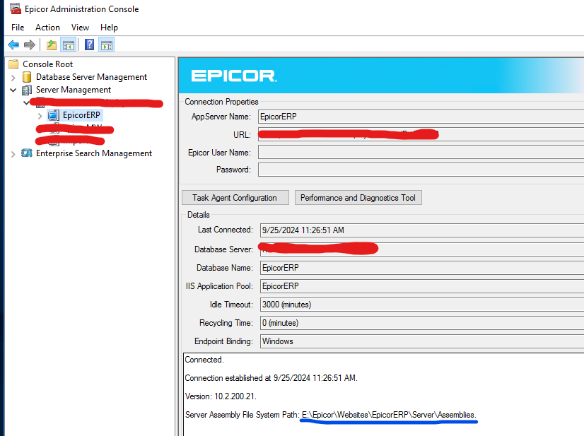

In your Epicor Admin Console, if you select your server under Server Management > Server URL, you’ll see the Server Assembly file path in the text box at the bottom:
Everything before the “Assemblies” is the path to your server folder. Follow the path Greg mentioned from there. So in this example, the path is E:\Epicor\Websites\EpicorERP\Server\Erp\EI\
