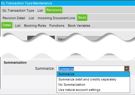

@ckrusen It is the COSandWIP posting rule that @LarsonSolutions is showing above. On the book tab change Summarize to No summarization. Or in my case flip it back to default.
here is a KB on the process to switch. KB0029513

Interesting - I found the setting you are referring to…
The rule is currently set to summarize, but here’s all of the details.
So not sure what is getting summarized.
In my testing and modifying this rule, I have not checked or changed that setting.

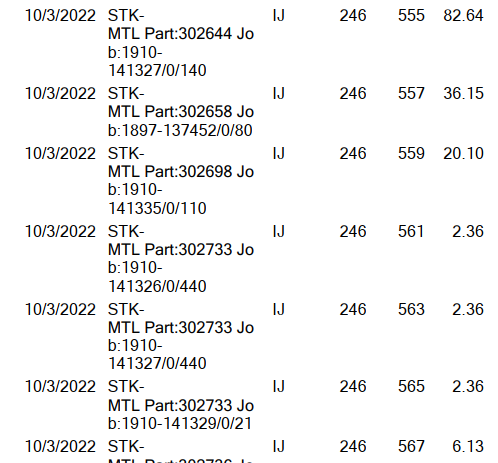

@LarsonSolutions Is there a way to not do this because for me this will make me very unhappy.
Is there any summary or are they just assigning a new sequence number to every line and essentially making it detail?
I just compared my GL Report PD 12 from 2021 339 pages to 2014 PD 12 2574 pages and we are twice the size were were then. I do not want to wade thru thousands of pages in the general ledger.

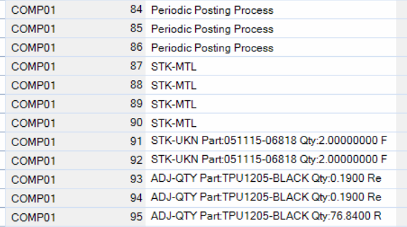

Do any transactions to this account still show as “Periodic Posting Process”?
Maybe my thoughts about the PE grouping items into a single GL entry, does group on the description too.
Think about it. If all the STK-MTL part trans have default description of “Periodic Posting Process” and the grouping is by GL Acct, Apply Date, and Description, then you’d get one entry for each day, with the “PPP” description.
But if the PE applies a description first, then you’d get a new GL line for each different description.
If your PE rule was to set the description to be just the job number, the GL would show just 2 entries.
10/3/22 STK-MTL JOB 1910 IJ 246 555  113.52
10/3/22 STK-MTL JOB 1897 IJ 246 556   36.15

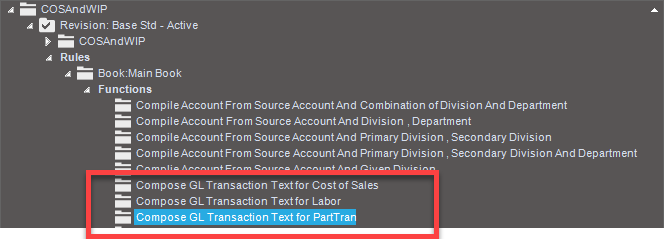

@utaylor I found a KB KB0124377 (link below) and the change is not bad, but I also found a gold mine as an offshoot of this change. There is a new function User Extended Description which the word doc at the bottom of the KB tells you how to change the value of the function to False. There is also another function Compose GL Transaction Text for PartTran which sets all of the Transaction Text values and is referenced in every posting rule now. It has every transaction type already built.
If you remove the first If condition then the function applies even if Use Extended Descriptions is false.
If I want all of the details on shipments, but want all issues to jobs not to say periodic, but still be in one entry then you can make the entry simple like the STK-MTL below and the posting engine will split based on the account and description.
Any you don’t care about at all just delete and they will have the default again.
If you do delete items it will delete all lines of the condition.
