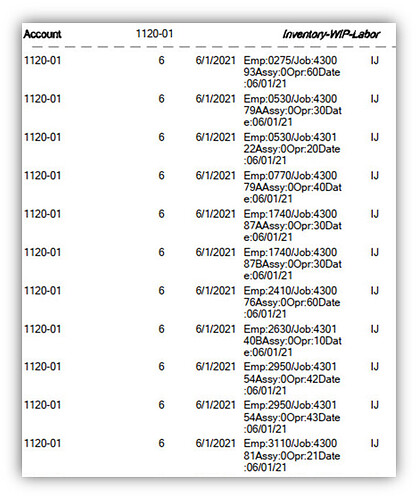

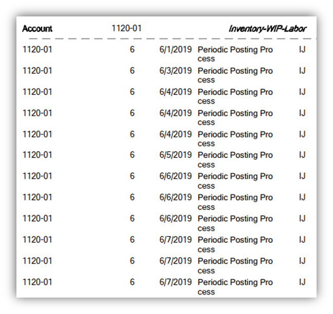

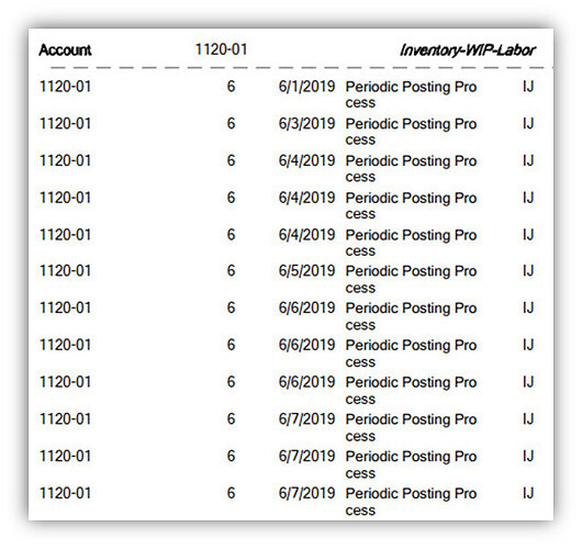

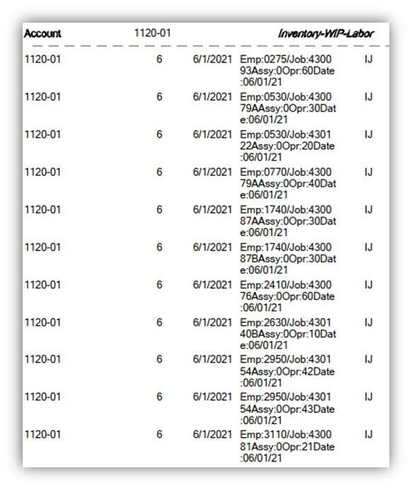

Example of labor records before and after.
Before
After
With this change there still may be a need to change the information for some customers, but it will be a little easier now with the base rules in place.

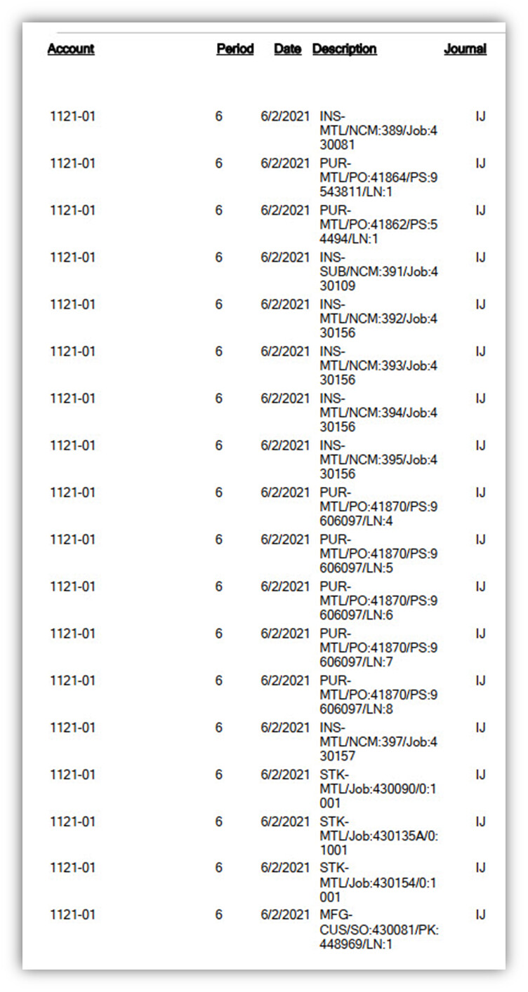

Here’s some purchasing transactions.
Note: examples shown are from my changes not Epicor’s changes to the rules.
