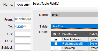

When sending the order acknowledgement using the APR routing process, an email gets sent to the customer based on the routing but we would like it also sent to the user who is currently logged into that session that manually sent the acknowledgement through the routing process using their UserFile.EmailAddress.
@cchang If you add a field to Orderhed for the current user’s email and populate it on opening the order then add that field to the Order Ack RDD so it will be a field available in the routing to use in the template.
Does selecting the table UserFile in the APR and checkingthe EmailAddress field auto email to the current user logged in when selecting the report style?
@cchang Given the table is UserFile and the field is EmailAddress It seems reasonable that would work.
I tried that and it seems to take the UserFile from the user that created the PO and not the current logged in user. It doesn’t seem to work as expected from the current logged in user.

And if it is true, how is the UserFile table being joined to your report data definition @cchang ?
I believe it is the standard PO RDD. How would we add the UserFile to the current user and not what is in the RDD or if this needs to be done through custom code.
