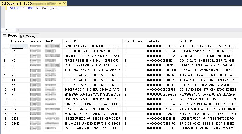

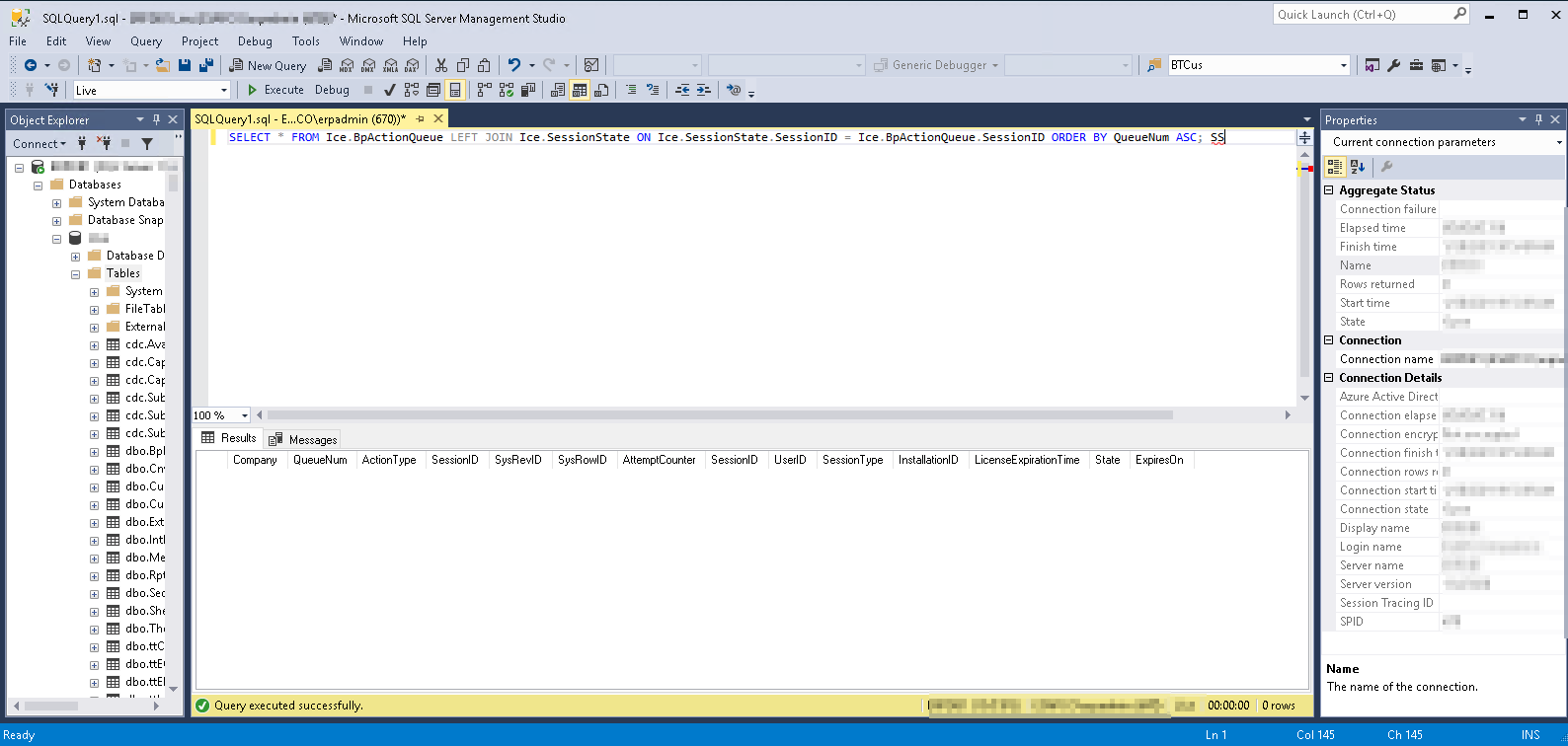

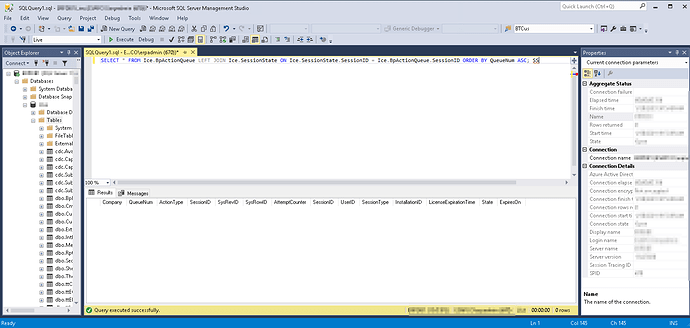

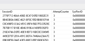

I executed @hkeric.wci’s SQL script, but there were no records when I executed the query in SSMS. Then I ran it for just Ice.MailQueue, and did get 18 records (some ancient based on a user that hasn’t been here for 3 years, others I don’t know): BPM Emails not working all of a sudden

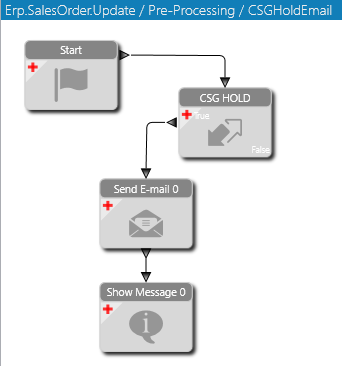

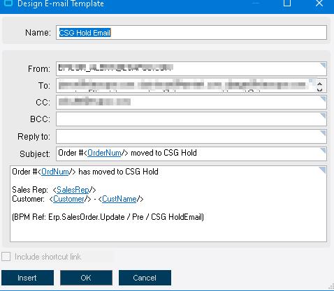

Here is my super simple BPM:

The only reason I assume he is failing at the beginning (not even delivering to target) was because the AttemptCounter. I kind of excluded spam possiblities.

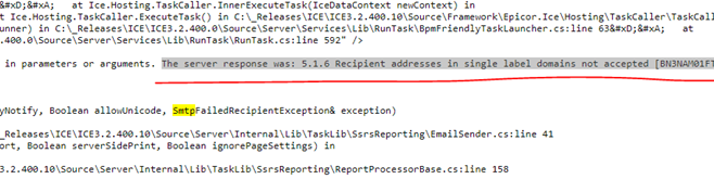

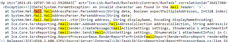

Hey @hkeric.wci
Is this the ServerLog.txt file, or is what you show from the Task Agent Log? My Task agent log in c:\ProgramData is empty - what setting do you have within the TaskAgent Service Config file to get the above level of logging?
Many Thanks!
Yes its the ServerLog.txt usually inside the IIS folder on the server.
