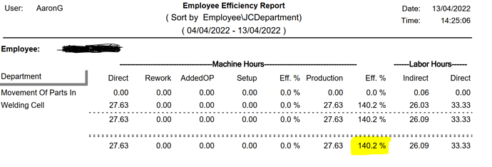

Hello,
Someone able to help me figure how this is calculated?
What fields in epicor make up this calculation?
Aaron.
Hello,
Aaron.
Typically I’ve seen the documentation specify that Emp Eff is (Estimated Hours / Actual Hours) * 100.
Estimates are not on this report and I’m not exactly sure how Epicor divides up JobOper Estimated hours when more than one operator works the job - maybe it’s based on a calculated rate and the completed qty clocked by the operator? And that is what is used to determine Emp Eff?
And this report is actually an average Eff % in the department, for the time range of the report.
Take a look at the system BAQ that feeds that report. In there you will find the calculated fields and you can see their syntax. I found this formula:
(case when BurdProdHrs = 0 then 0 else
(LaborDtl.EarnedHrs / BurdProdHrs) end)
The baq is called: zEmployeeEfficiency
Forgot about that @NateS - and it looks like my guess was correct to a certain extent.
Field Help on Job Tracker says Earned Hours is
“The amount of hours that it should have taken (based on standard) to produce the reported LaborQty. For Setup labor the Earned hours is the lessor of (Est.Setup - ActSetUp) or LaborDtl.BurdenHrs. Rework labor always has zero Earned hrs. Earned hours for production labor is calculated as (JobOper.EstProdHours / JobOper.RunQty) * LaborDtl.LaborQty”
