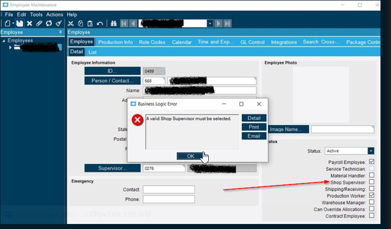

Dear experts,
We are implementing Time & Expense multiple level approval. While attaching Supervisor to Employee system is throwing Business Logic Error -A valid Shop Supervisor must be selected.
Could you please suggest how to resolve this issue?
check to see if the supervisor 0276 has the Shop Supervisor option checked…
I have searched Employee-0276 and check that Shop Supervisor option was not selected. After that , I have checked the Shop Supervisor option & trying to save the record. System is throwing bussiness logic error “If Time or Expense Approvals are required in SiteConfCtrl, SupervisorID must be entered.”
Looks like all employees must have a supervisor. We have the CFO as a supervisor for the CEO and vice versa.
Brett
You must have a supervisor assignment when that checkbox is enabled. We will assign the top level as a supervisor of them self and then enable the auto approve time entry checkbox on the employee if they key time.
We have Search Employee-0276 and Make him self supervisor and selected the Shop Supervisor option.
After that it is working fine.
