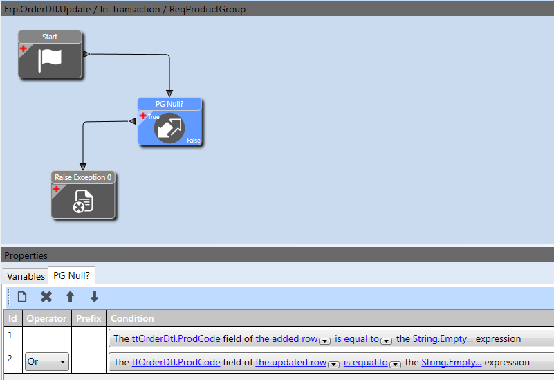

Sounds like a simple binary field (1 = Male, 0 = Female).
You should be able to make the field required with a Data Directive (In-Transaction) against whatever table you’re adding that UD column to.
Below is an example I have which makes the Product Group required on an Sales Order Line (OrderDtl).
What I’m NOT sure of, is, with a binary field, whether you have to choose a default value. Hopefully when you create the UD column you can set the default to be empty. Then the Data Directive will not allow them to save the record unless the user selects a value.
