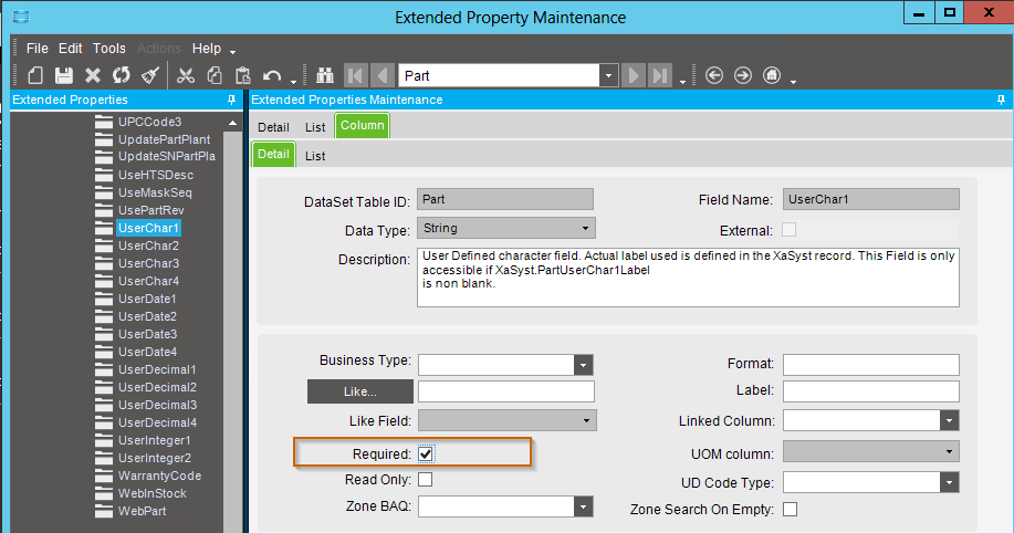

another option is through Extended Property Maintenance which is my preference everything else being equal. Requiring a field to be populated through the UI is just a checkbox.

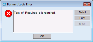

Record is not created when the required field is left blank, get a warning like

The record can be updated after changing the UD field value to non-Null. But deleting the UD value (making it NULL after it was saved as non-NULL), does not update, and a message similary the one above
("< fieldname > is required") is displayed.

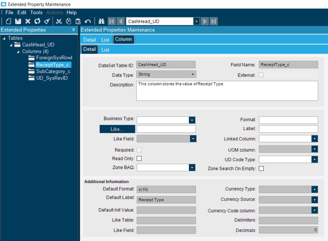

When we are trying to make UD field mandatory through “Extended Property Maintenance”. But Required checkbox is showing disable refer to below screen
Please suggest how to make this field mandatory.

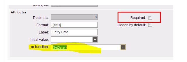

I did it in the Extended UD Table Maint.
(ignore the highlighted part)
I’d guess that a Data Regen would be required after making that change.
Ditto
