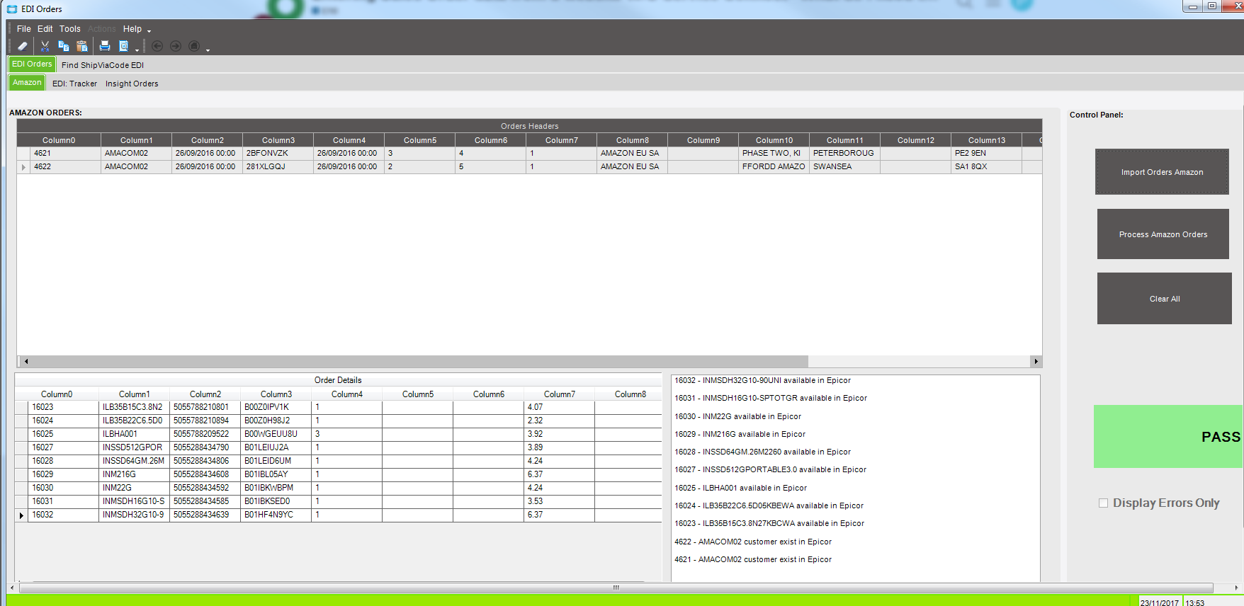

I have done something similar to that, which I attached as screenshot …
