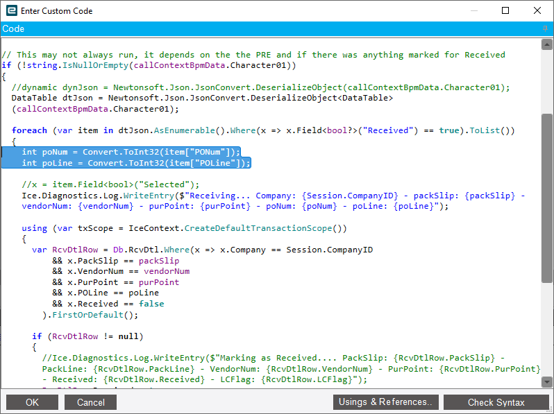

I think the keyword being complex data types… I think is it in Data Directive or Method Directive often when I use parentRow.UDField<string>("...") that I have to assign it first to a variable or it crashes during runtime, or is it when I mix Db with ttTables… I dont remember.
Perhaps Jeff example lacks more context – parentRow.Key1 should work.
The one example I can find is this, where I cant just use Convert.ToInt32(item[“PONum”]) in the query below. I had to assign it to variables first.
But this was EF 6… not sure if EF Core is even more stricter, or perhaps its because I have it in a foreach loop and not in a .FirstOrDefault()…
I almost typed out that @hkeric.wci was going to eat up @dmmory 's question about being able to do it in visual studio or whatever. Love to see this type of exchange, great insights and knowledge.
@dmmory , I think the difference is you have two separate EF Core queries being executed in your example. If you put them into a single EF Core query, I think it will blow up. You would probably be OK if you only used the Id column. The issue comes when you have the “complex” data for the batch row. It’s been a while since I looked at this exact issue though.

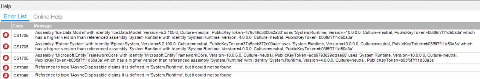

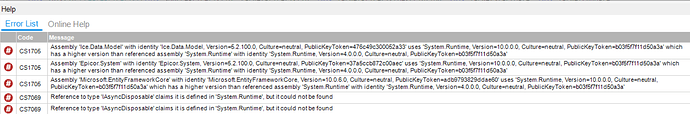

Now, since the 2026.100 upgrade, I’ve got a whole bunch of error message :
Is it related ?
That looks like local errors, does it still save?
If it does, Epicor is looking at the wrong .net stuff locally.
No, it would not let me save.
Also, we’re on cloud ; didn’t know that local .net stuff could be an issue, The exact same code compiles just fine in Prod at the moment.
Did you get out, ignore errors, and save from the main page?
Go in, add a comment or something, ignore the errors, and save from the main page.
Ok sorry I got what you mean. Yes, I can ignore errors and save from the main page.
