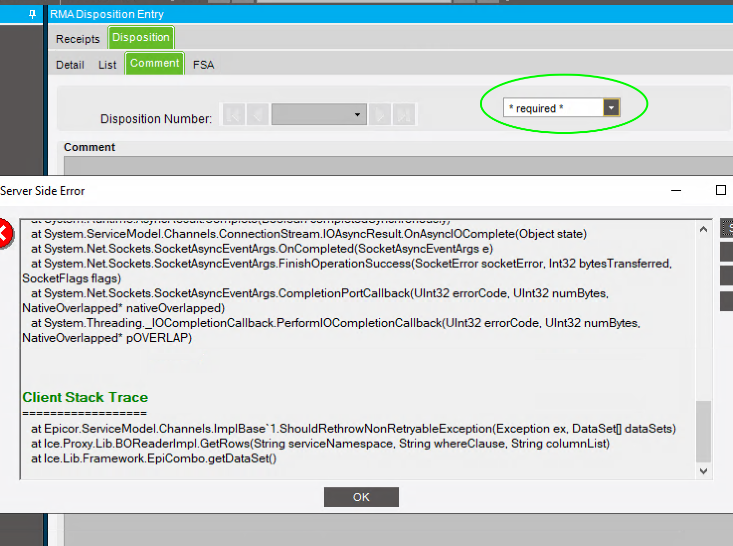

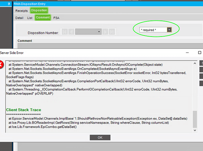

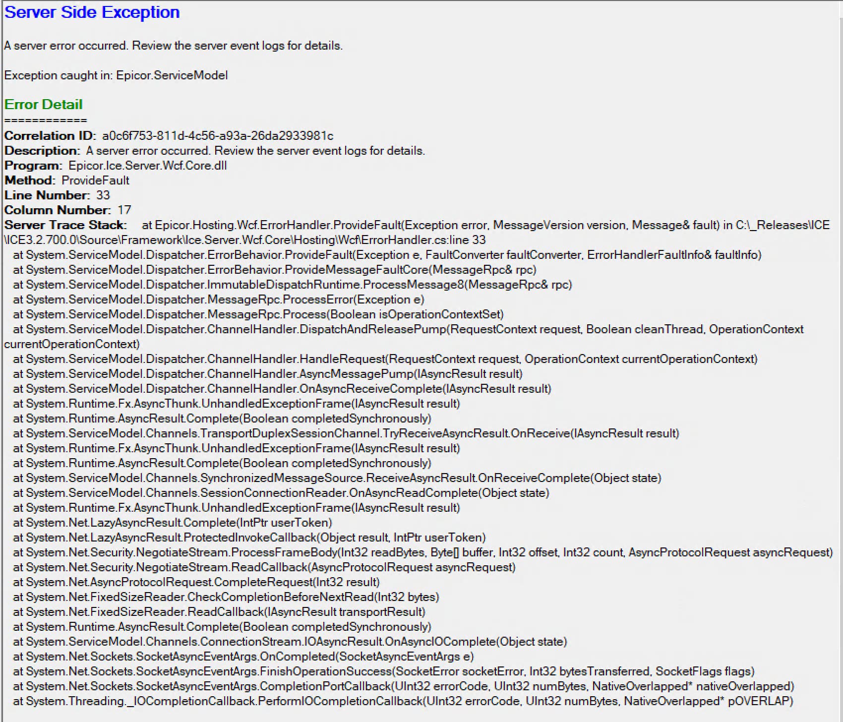

I have created some UserCodes of type Fault and now want to add an EpiCombo which is a drop-down of these fault types. I have replicated the settings from a working EpicCombo that I created in the past but just can’t get this one to work. I must be overlooking something simple but can’t see it. Can anyone help please?
This is the error that I see:

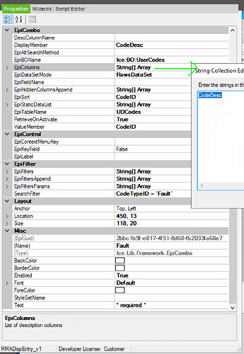

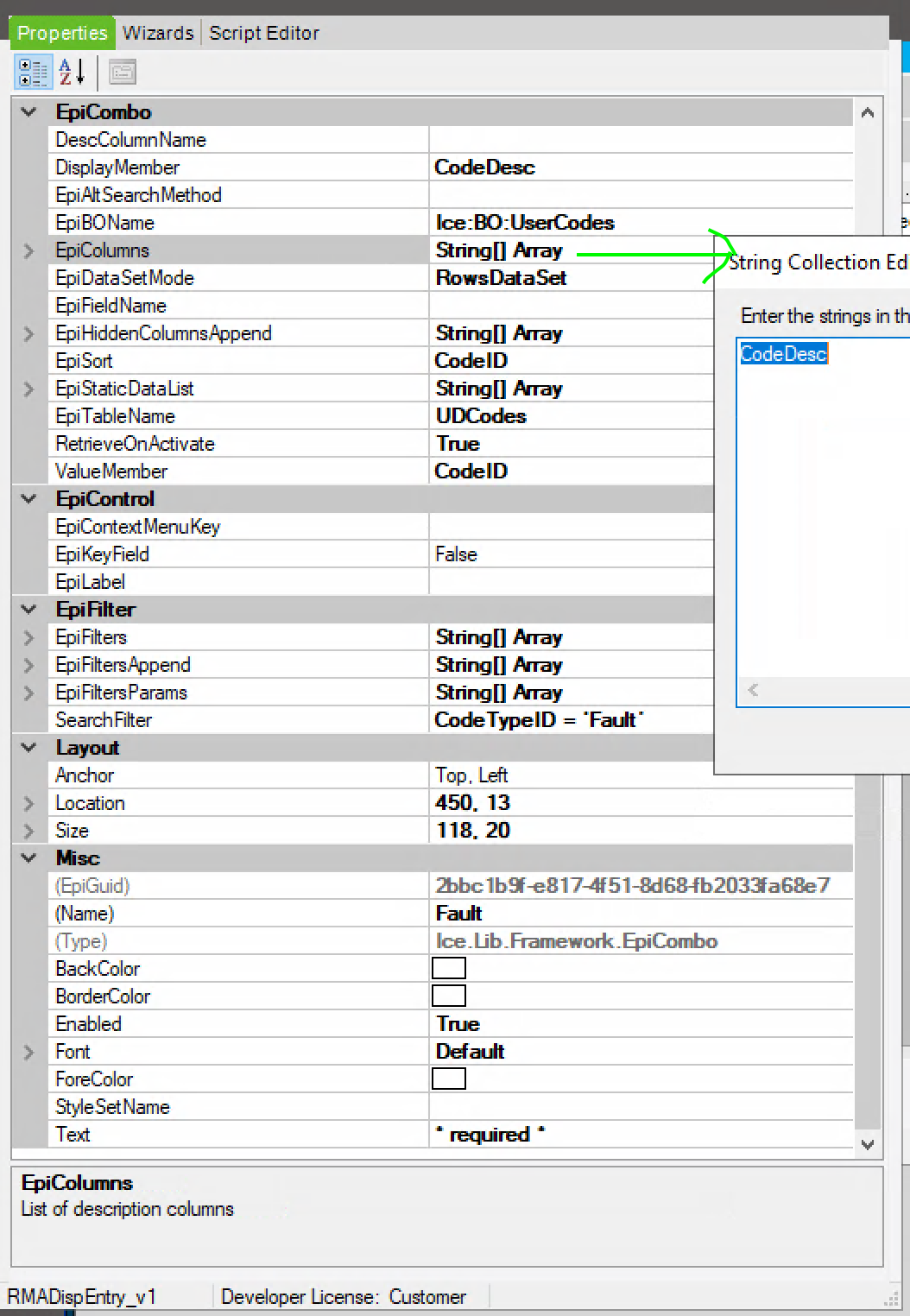

And this is the setup:
I don’t know if actually necessary, but I did do a database regen and restarted the app server just to rule that out as a possible cause.

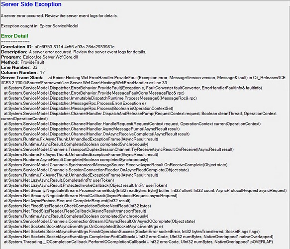

Can you scroll to the top and post the whole error msg please?

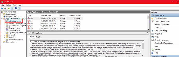

Can you locate the error in the server app log?
Yes, if someone can tell me how to do that. I have not accessed apps server logs before and don’t know where they’re located.
On your main application server:
Ice.Common.EpicorServerException: Incorrect syntax near '‘'. ---> System.Data.SqlClient.SqlException: Incorrect syntax near '‘'.

So the first line of that App Server error message piqued my interest. This is what ended up being the problem:
The EpiCombo Search Filter was set to:
CodeTypeID = ‘Fault’
but it needed to be this instead:
CodeTypeID = 'Fault'
VERY subtle and practically visually indistinguishable! But it works now.
Yep nice find! Hard to tell from that screenshot
