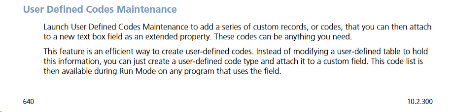

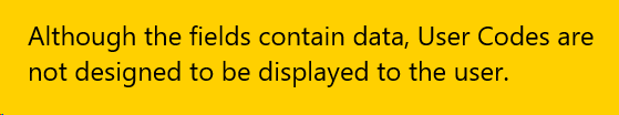

If it is indeed intended behavior then it needs to be added to the Documentation stating so. The following pages should be modified:
to indicate the designed behavior. Maybe a call-out like this?
