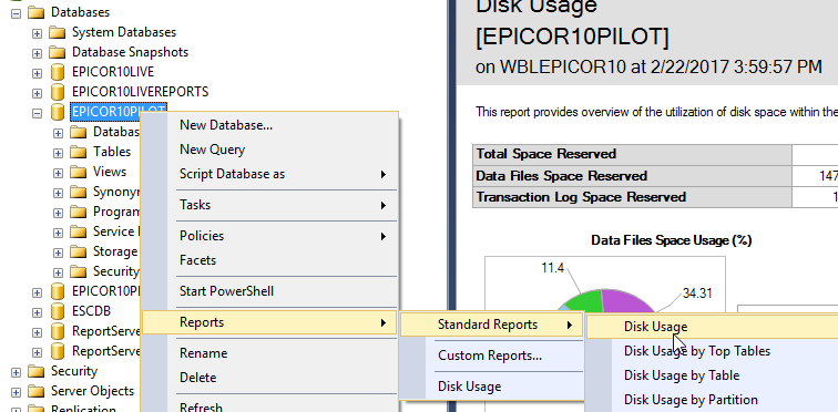

I would check more into the disk usage statistics on the SQL server. Specifically average queue length, we were having issues with average queue length getting to high during a migration and it was being caused by the database autogrowing every 10GB.
You can see the latest autogrow statistics for a DB in SSMS under the Disk Usage report just below the graphs. The disk usage report can be found here;
I haven’t had the pleasure of using the DMT tool, so there may be an issue with that instead or maybe as well as a disk IO issue.
