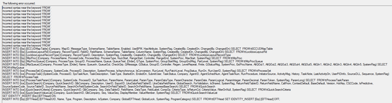

This is the sql its having trouble with.

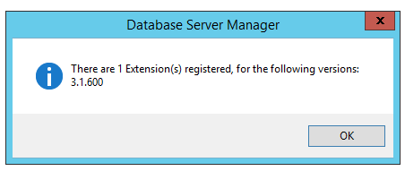

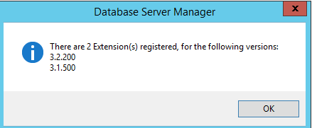

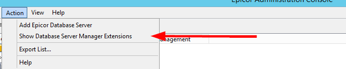

If this system is setup for 10.2, it will require an extension for the AdminConsole to work with 10.x
