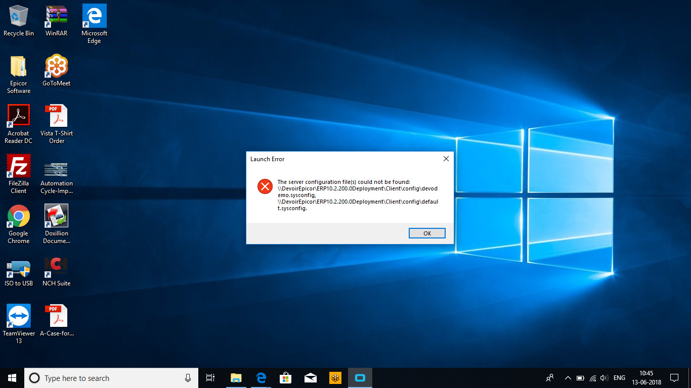

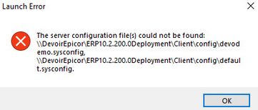

Above screen shot error I am getting when I try to run the client from my local pc, having the server in Azure.

That error is just a vanilla pathing issue, nothing to do with E10 per se.
What is that path for your client?
Does your client have access to that file?
Does the file exist?
No, as the files are residing in Azure cloud VM machine . and I am not having access to it from local pc. That’s the piece of steps I am missing I believe, and how to get the access to VM machine c drive from my local pc, so I can start accessing the E10 client.
