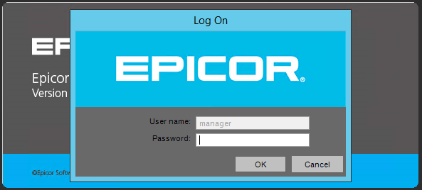

I get two login Prompts (why?):

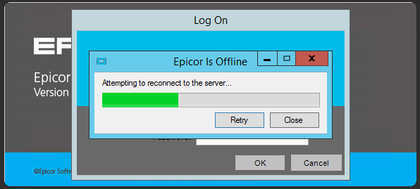

And then it fails with:
Other users are fine.

We were getting this when we upgraded to 10.2.500.7. The issue seemed to be with the Config file for the specific local environment. For the parameter we got this second login screen when we had the Fully Qualified Domain Name of our server. Once I shortened to just server name only I stopped getting the second login screen

Sounds like a Trust glitch. Like the client computer trusts \\Appserver, but doesn’t trust \\Appserver.AcemInc.com
And the second login is the program validating access to the untrusted resource.

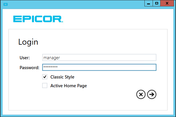

Happens in classic. Switch to modern or active and you wont get the propt.
