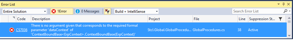

Epicor 10.2: There is no argument given that corresponds to the required formal parameter 'dataContext' of 'ContextBoundBase<ErpContext>.ContextBoundBase(ErpContext)'
I am trying to build my existing objects for Epicor 10.2. Here taking all the references with respect to E10.2
Getting the below error message at the time of build:
There is no argument given that corresponds to the required formal parameter ‘dataContext’ of 'ContextBoundBase.ContextBoundBase(ErpContext)'
NOTE: For E10.1.600 not getting such error.
Any solution for this error!!..

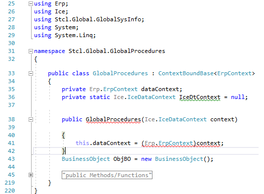

This code for making DLL to be called as external reference by the BPM, which is validate for the Commitment control.
Below is the code:
global_error
Same code is works in Epicor-10.1.600.18 but it is failing in E-10.2
And below with the error:
Line 38 is wrong - not sure why it ever worked to be honest. Possibly something specific to the service. If you are deriving the class off CBB then the ctor needs to be the same Type - ErpContext.
I assume line 38 should be:
public GlobalProcedures(ErpContext context)
but I may be missing something
based on my understanding replace line number 33 with public class GlobalProcedures and try

I have been changed the code as per your suggestion & also added :base(context). Code has build successfully, but it is showing an error while trying to execute User defined Stored Procedure. Code is not reaching inside the For Each loop due to Db is getting Null.

If you are calling the external Method, the ‘Create API’ will generate a POCO - no base class. The DB Context will be passed to you. There is no need to derive off ContextBoundBase unless you are creating new services and libraries. I work with a lot of partners - internal and external - who go into creating whole new products on the SDK so was not thinking about the BPM aspect.
If doing a simple External Method than generate the API from the Actions on the main page and it will give you something like this (This is from UserFIle)
