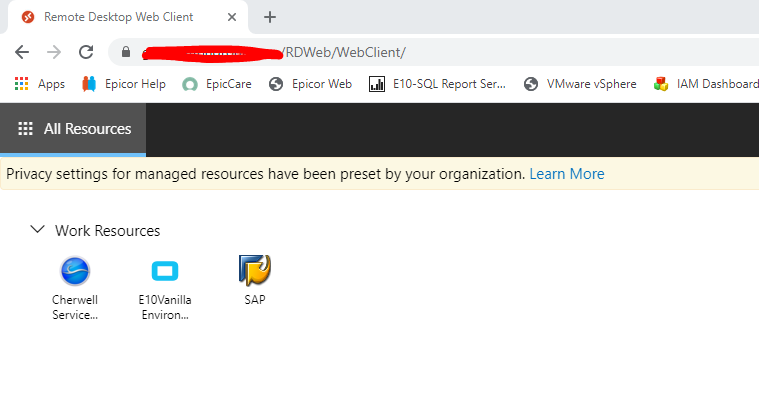

Is anyone using the RD Web Access server from Microsoft for Epicor 10?

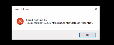

We are testing it and I am getting an error… when I try to launch Epicor via the web access.
We run pretty much all clients as RD Apps. The few that don’t do so for local printing issues.
I’d bet what you are seeing is a permissions issue with between the User and the RD server. And shouldn’t be client O/S dependent (the O/S of the workstation connecting to the RD App server). The “C:” it is referring to is the C: drive of the RD App server.

not sure if any of these screen shots help or not…I mean if others are using it I must be missing something…Just don’t know what…I have suspicions.
I can get here…
then is starts…
but then fails here…

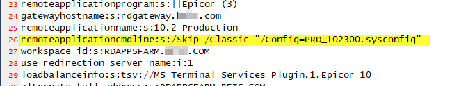

FWIW - The RD App gets downloaded to my workstation (because I use Chrome and not Edge). So I can see all the settings it uses. I noticed the setting highlighted below uses the /Config switch. Are you using that in the RD App setup?

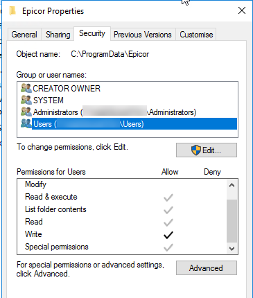

Just a stab in the dark here, but what are the security settings of your c:\ProgramData\Epicor Folder.
Ours are
image .
