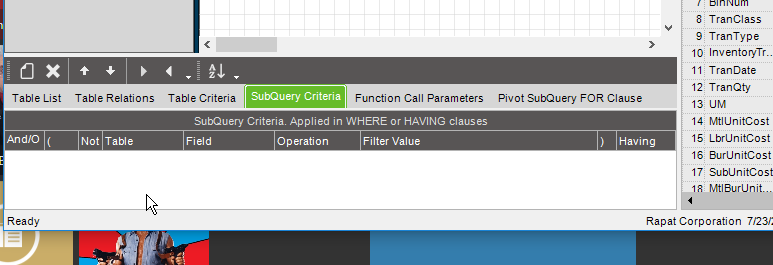

Can you show me your subquery settings? I’m wondering if you have the subquery set as the top level.

Then in your subquery criteria, set it so the summed quantity equals the max qty.
Okay, I removed the group by’s and used the partition by equation:
I then made a subquery criteria where the sum qty calculated field equaled the max qty calculated field:
but I get this error when I ran the query:
