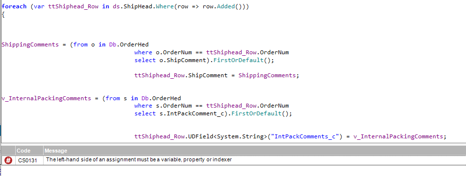

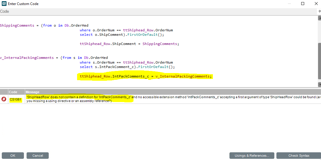

Hello all
Does anyone know of an easy way to call in a UD table/field into Custom Code of a BPM please? I’ve highlighted below the issue we are seeing, its not recognizing a UD field maybe because it’s in the ShipHead_UD table but I’ve tried ttShiphead_UD_Row and it doesn’t like that either…
Many thanks for your help !
You have to use the UDField extension of the object

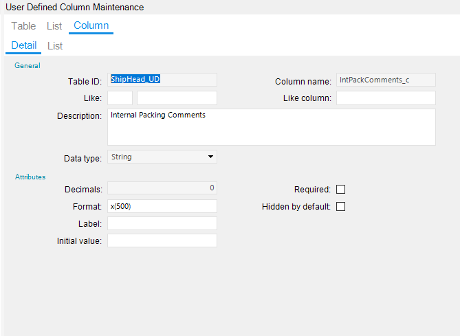

Hi Josec,
Thank you so much, I’ve checked and it tallys up to what is listed in the UD maintenance

Thank you both!! The below worked a charm!
ttShiphead_Row.UDField<System.String>(“IntPackComments_c”)
I just had to switch the variable around so it was on the left.

left side is being set by the right side. is that what you want?
mto29
(Mic)
June 19, 2024, 4:11pm
8

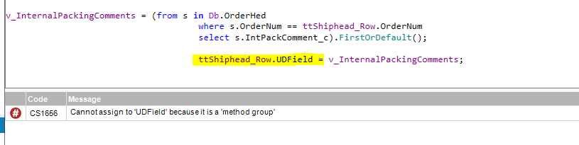

Oh no… we want the Order Comments to update the IntShipComment field
But when I switch them back around, it asks for a variable
klincecum
(Kevin Lincecum)
June 19, 2024, 4:14pm
9
There should be a SetUDField I think to do the reverse.
knash
(Ken Nash)
June 19, 2024, 4:30pm
10
ttShiphead_Row.SetUDField<System.String>(“IntPackComments_c”)
gpayne
(Greg Payne)
June 19, 2024, 7:17pm
11
this is the syntax
myTTRecord.SetUDField<string>("MyField",myValue); // Will Set it
