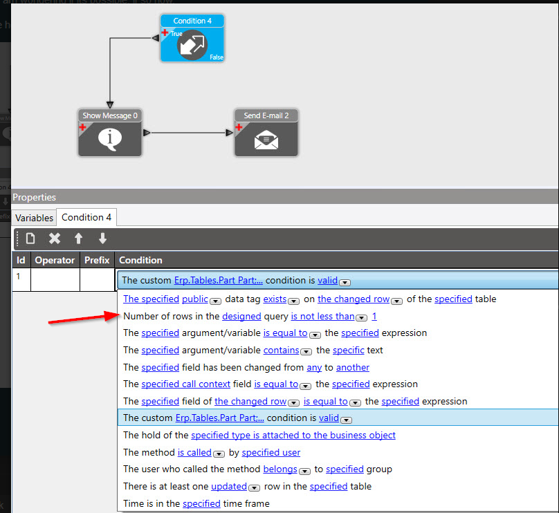

The condition widget can do this without code. It’s the “Number of Rows in…” option.

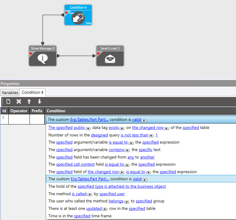

Ok, that’s not it.
The Code is Valid.
I need to return true or false.
Hopefully the picture helps.

What I am trying to achieve is to do a condition that returns a true or false.
So I can then do other things like e-mail or messages or etc.
I just need to know if its possible to do this, because it seems by dragging the Execute custom code caller does not seem to be able to return a value.
I then tried to use the Condition flow chart.
But the only custom code available condition returns valid or invalid rather than true or false.
Please forgive me for not speaking programmer lingo.
I have provided a picture hoping to help you understand what I am trying to achieve in this example.
At this point I am wondering if its possible, if so how.
