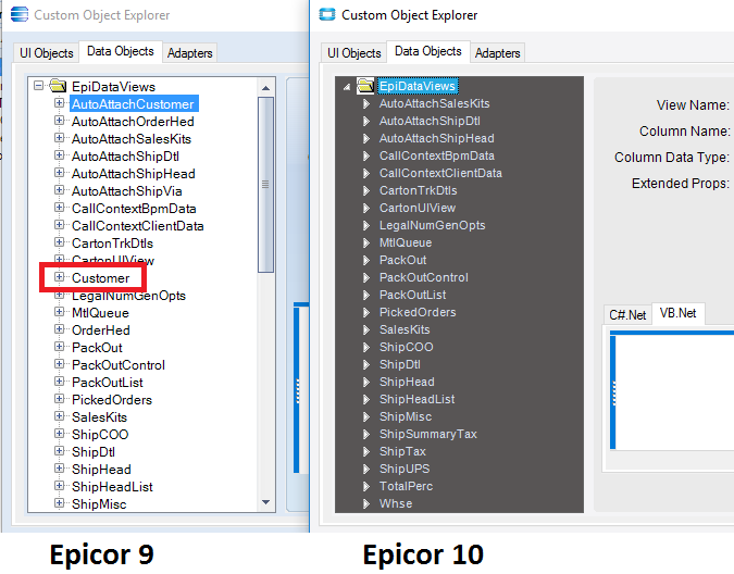

In Epicor 9, there is a “Customer” entry in the “Custom Object Explorer”, however I do not have it in Epicor 10 (see image).
All of the customizations for E9 were performed long before I came onboard at this company, so I am not sure what was done (if anything) to make the Customer data object available to use.
I assume there is something obvious that I am overlooking, but I can’t seem to figure it out. I added the references for anything Customer related to the Assembly Reference Manager, but it seems that was not the issue. Where else should I be looking?
It was probably a ForeignKeyView or FKV you can learn about these in the Ice TOols Customization Guide.
