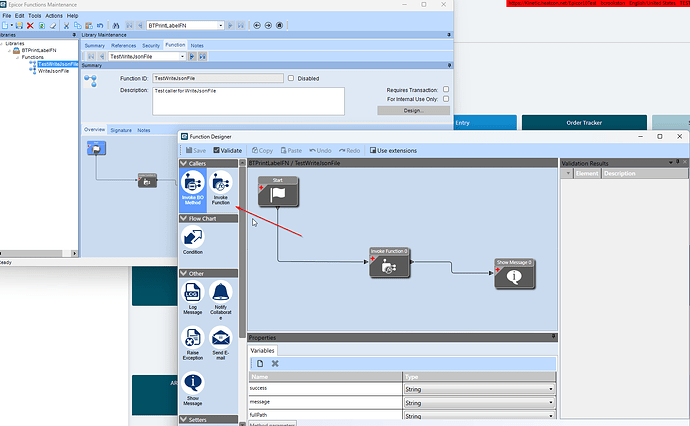

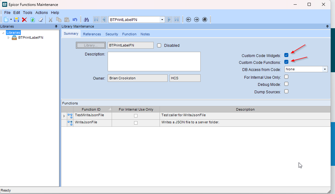

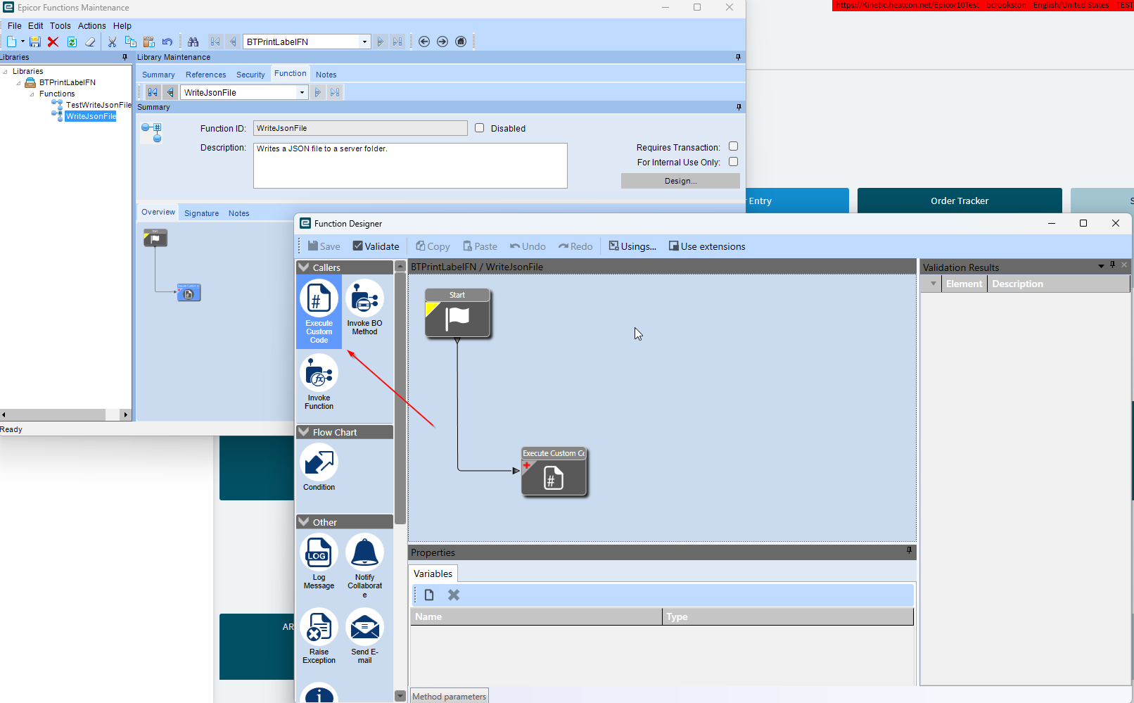

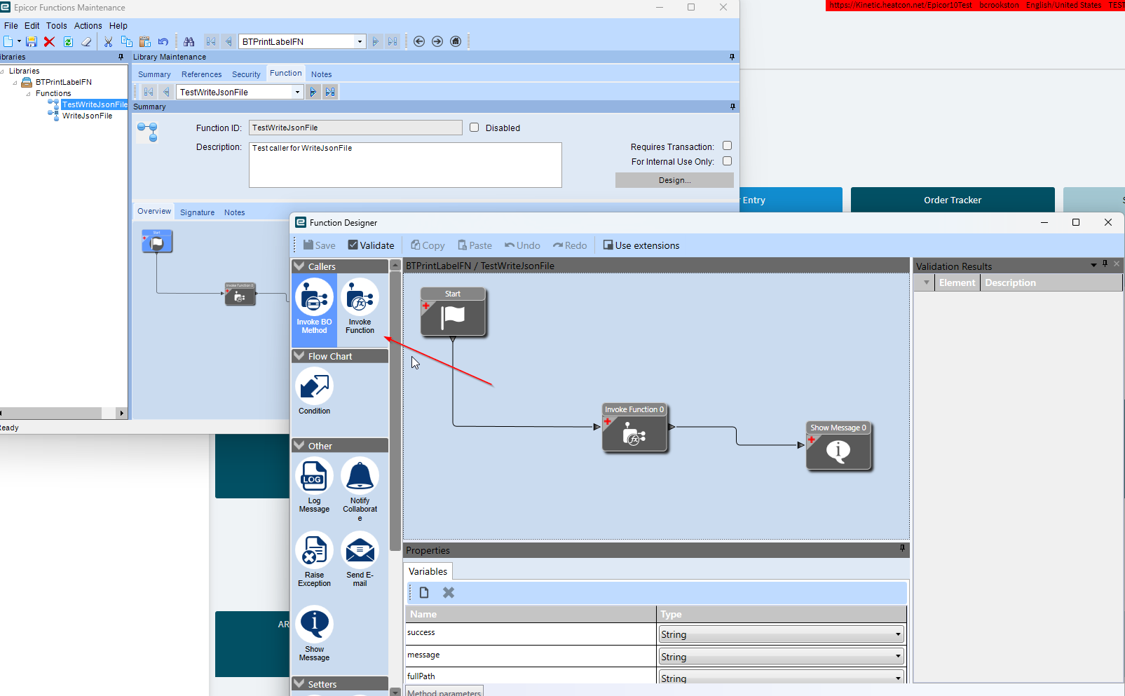

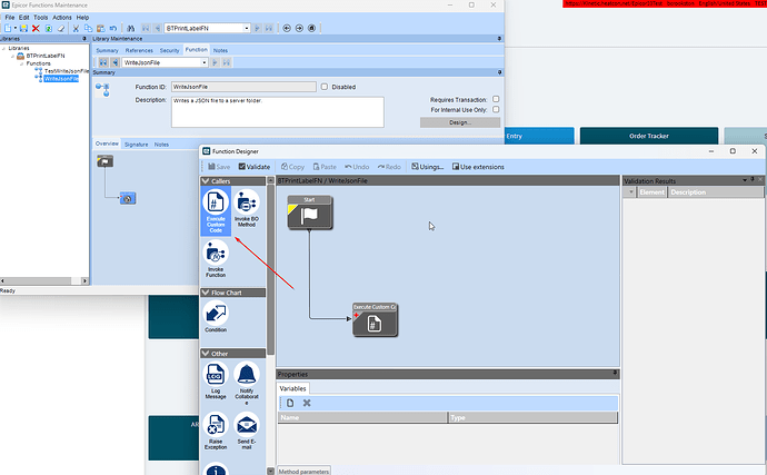

Here are screenshots showing what I’m seeing. The first function I created was WriteJsonFile, and it included the Execute Custom Code option. However, when I created TestWriteJsonFile, that option wasn’t available.
I don’t actually need the option for TestWriteJsonFile, since I only created it to test whether I could return results. I just find it strange that the option is available for one function but not the other, even though they were created in the same way.
Here is a screen recording of me creating a test library and then creating the function. If the video works, you’ll see that the Execute Custom Code option is unavailable when I create the function.
Also this is in classic as the web version does not support Epicor Functions Maintenance.
