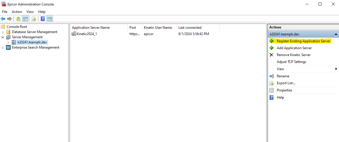

You can save the configuration of an application server to an xml file via actions Create Config Setup File, but I can’t see how to use this to create a new environment? I’ve edited the xml to create a modified copy of an existing app server but now, how/where can I use it?

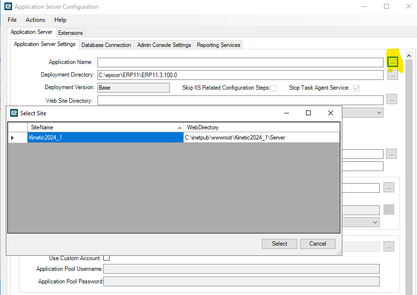

No, it just seemed to bring up the same window as Add Application server, where you have to set everything up manually.
Interesting. I’m used to clicking on this button with the ‘…’ and getting a list of applications servers whose XML files are in the config folder and then registering them.

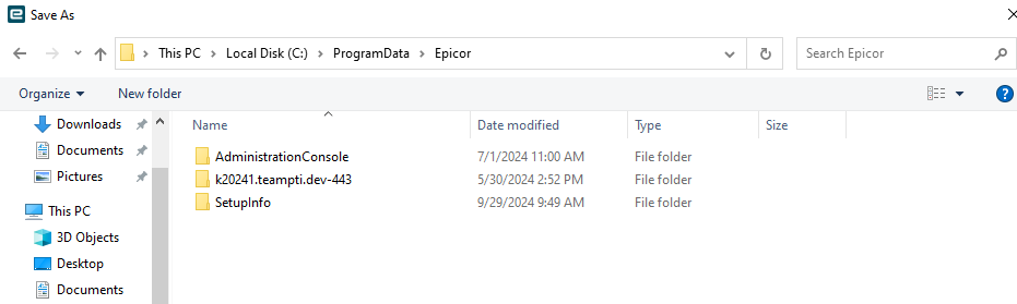

Ultimately, the data is stored in these folders. Maybe looking at what’s there, you can piecemeal it in?

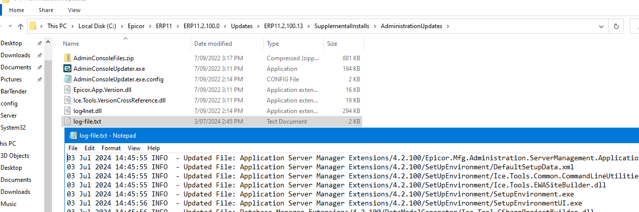

I can also see the log file for the update install shows that the SetupEnvironmentUI.exe gets updated, at least for 2022.1, so it might be similar for your version.
In our real environment we are going to 2023.2.22 and I also see a similar log.
