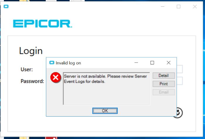

Hi all,
When i tried top open the Epicor application getting this error. Please support.
Error Log::
Error Detail
Message: Server is not available. Please review Server Event Logs for details.
Inner Exception Message: An unsecured or incorrectly secured fault was received from the other party. See the inner FaultException for the fault code and detail.
Program: Epicor.ServiceModel.dll
Method: ShouldRethrowNonRetryableException

Please post your event viewer server logs.
Did you ever resolve the meaning and cause of this error?
We received it this weekend and I am trying to find the “Inner FaultException” for its fault code and detail.
Thanks if you can follow-up, It would be much appreciated!
If you’re receiving the same error, we would need you to go to the sever, open the Event Viewer, and show us what the log says.
