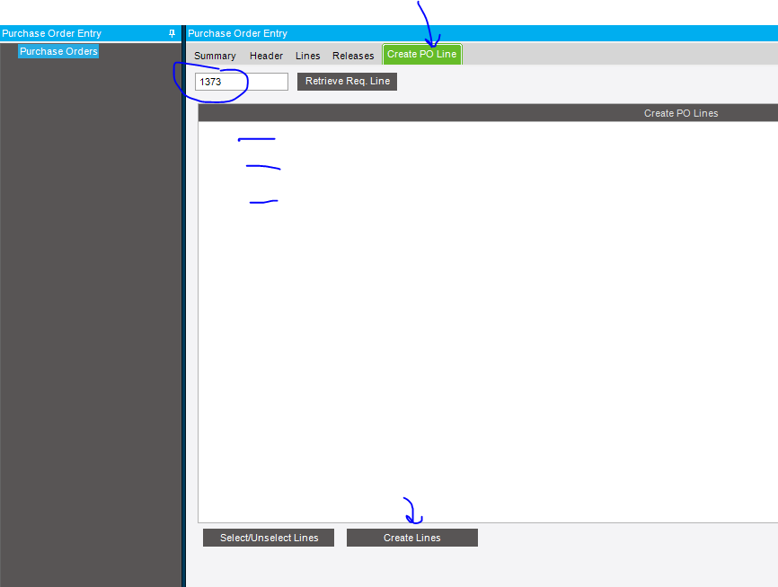

I have successfully achieved creating the PO Lines, Releases and linking to Requisition Lines based on additional Tab on PO Entry that shows Approved Req. Lines.
However, I am looking to encapulate all 3 areas under Transaction Scope.
I tried to use the Transaction Scope, but system is not happy without including Assembly References. I tried to include System.Transaction dll file from : C:\Program Files (x86)\Reference Assemblies\Microsoft\Framework.NETFramework\v4.5 But looks like this is not working.

Ok - The need is to allow user to select Approved Requisition Lines using a Customized Grid, and Attach them in a PO, also Link the PO / PO Line to the Requisition Line
+josecgomez
Let me try to crash the code (through Debugging, I guess) and see if it does rollback. I feel that the PO Line and PO Rel can get rollback But will Req. Lines also ? a check is required.
