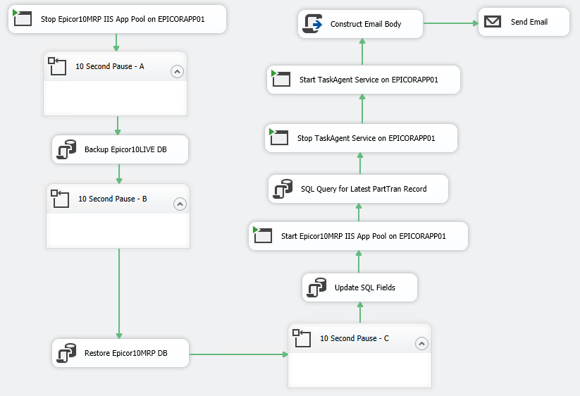

Depends how up to date you require - I have setup a package in SSIS (free with SQL Server) that does the following:
Backup Live DB
Stop TEST System AppPool
Restore live backup to TEST
SQL Script to amend TEST system name to “*** TEST SYSTEM - todays date ***”
Start TEST app pool
Restart Task Agent
This allows us to have current data to test and develop against. I actually run this on a script for one of our TEST environments, so that each day I have a system to check against if accounting have made a mistake etc and want to test the reversing documents before committing to live system.

Stop App Pool
Invoke-Command -ComputerName "EpicorAPP01" -ScriptBlock { Stop-WebAppPool -Name "ERP102300MRP" }
Backup DB
BACKUP DATABASE [Epicor10Live] TO  DISK = N'T:\AutoCopy_Epicor10DB.bak' WITH COPY_ONLY, NOFORMAT, INIT,  NAME = N'Epicor10Live-Full Database Backup', SKIP, NOREWIND, NOUNLOAD, COMPRESSION,  STATS = 10
Restore DB
ALTER DATABASE [Epicor10MRP] SET SINGLE_USER WITH ROLLBACK IMMEDIATE RESTORE DATABASE [Epicor10MRP] FROM  DISK = N'T:\AutoCopy_Epicor10DB.bak' WITH  FILE = 1,  MOVE N'Epicor10Live' TO N'M:\SQL DBs\Epicor10MRP.mdf',  MOVE N'Epicor10Live_log' TO N'L:\SQL Logs\Epicor10MRP_Log.ldf',  NOUNLOAD,  REPLACE,  STATS = 5
ALTER DATABASE [Epicor10MRP] SET MULTI_USER
GO
Update SQL Script
USE [Epicor10MRP]
GO
UPDATE [Erp].[Company]
	SET [Name] = '*** BV Dairy - MRP Test Environment ' + convert(varchar, GetDate(), 103) + ' ***'
	WHERE [Company] = 'BVD'
GO
UPDATE [Ice].[SysCompany]
GO
UPDATE [Ice].[FavItems]
   SET [AppServerURL] = REPLACE(AppServerURL, 'Live', 'MRP')
GO
UPDATE [Ice].[Menu]
   SET [Program] = REPLACE(Program, 'Live', 'MRP')
GO
   SET [EntSearchURL] = ''
GO
UPDATE [Ice].[SysConfig]
   SET [SysCharacter01] = ''
GO
UPDATE [Ice].[BpDirective]
   SET [IsEnabled] = 0
   WHERE [Source] = 'DB' and [BpMethodCode] = 'Erp.PartTran.Update' and [Name] = 'KanbanAutoPrint'
GO
Start App Pool
Invoke-Command -ComputerName "EpicorAPP01" -ScriptBlock { Start-WebAppPool -Name "ERP102300MRP" }
Build Email Body
public void Main()
			// TODO: Add your code here
            string body = string.Empty;
            body = "Epicor10LIVE Database has been copied to Epicor10MRP\n\n";
            body += "The LATEST Transaction Date in the newly copied Epicor10MRP DB is ";
            body += Dts.Variables["User::LatestTranDate"].Value;
            body += "\n\nIf this date is not today's date, then check to ensure the copy has worked as expected.";
            Dts.Variables["User::EmailBody"].Value = body;
            Dts.TaskResult = (int)ScriptResults.Success;
