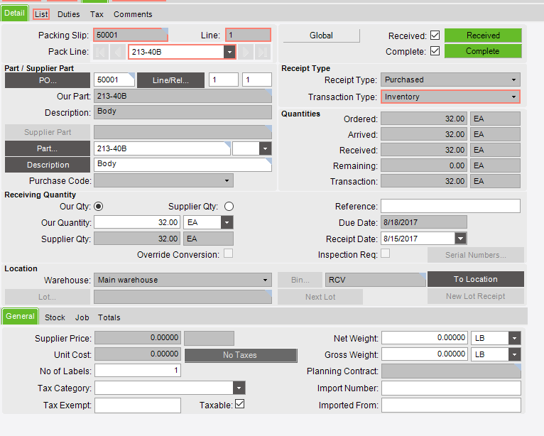

I need an easy solution to insert rows into an external table.For example, on the PO form under lines, I would like to have a button. When this button is pressed I want it to grab the PO number, the part number, the desciption, quantity received, number of labels. and have it insert those values into an external table. I have attached a screen shot of the lines page I will be grabbing the values from. I am still learning the in and outs of Epicor so more detail in the solution would be greatly appreciated.
