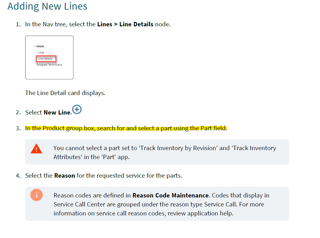

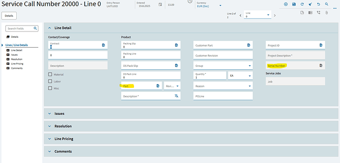

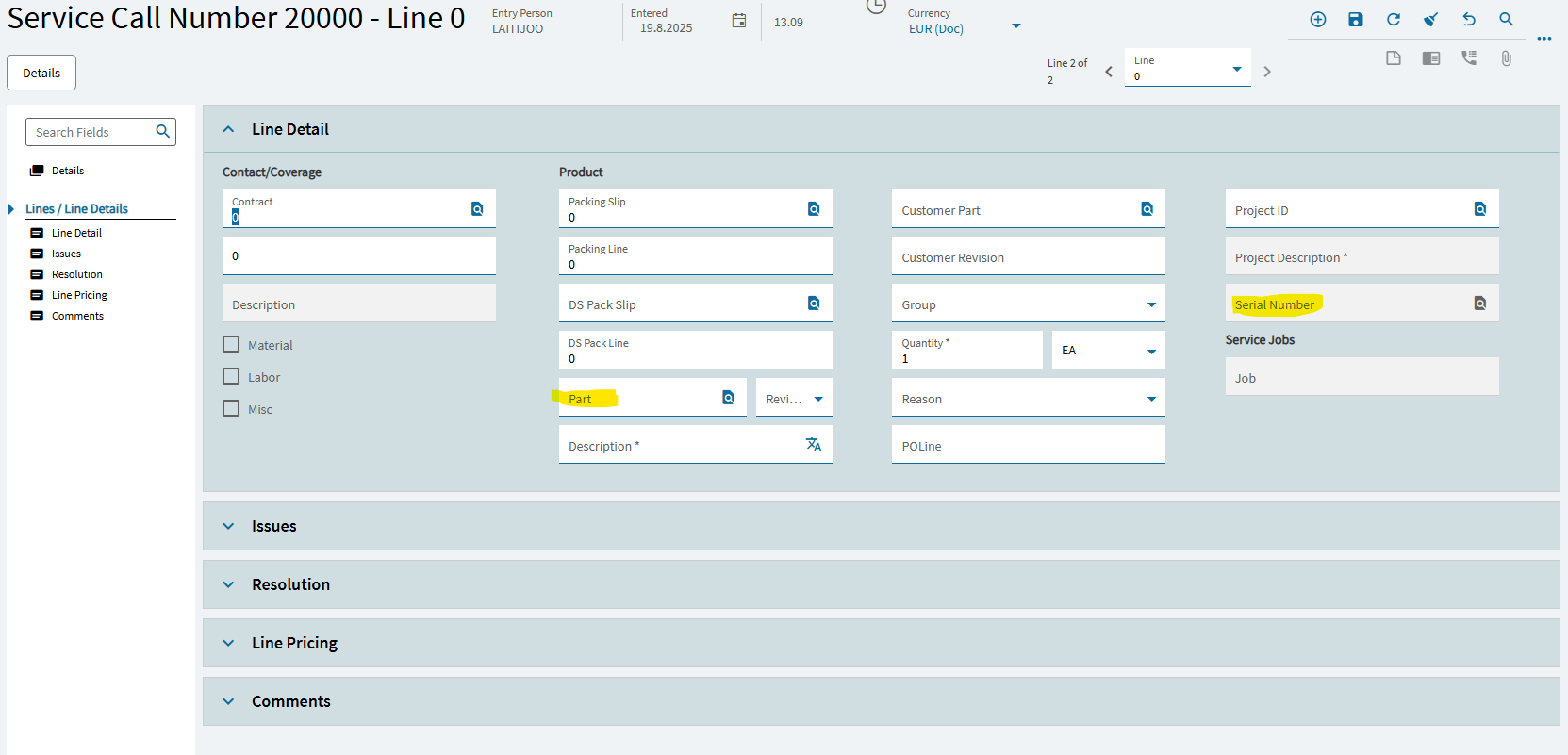

-In service call center line details, you should add the product to be serviced and the serial number. When opening a service job, the serial number is not transferred to the job. When dealing with a part that has a generative serial mask, it’s presumably not possible to assign the existing number. How should we handle the serial number on the service job?

I don’t remember the exact sequence of transactions, but there should be a “assign serial number to job” or something like that. If you check that, the part will be added to the job with the serial number. It’s been a while since I have been in field service, so sorry I can’t be more explicit.
On the service call? Can’t find anything to that effect. Standard Serial Number Assignment wants to create and assign the next number according to the generative mask.
How is the original part getting onto the service call? I forget how that happens, but if it is through a disposition, that is where the flag should be.
It’s just added in line details.
