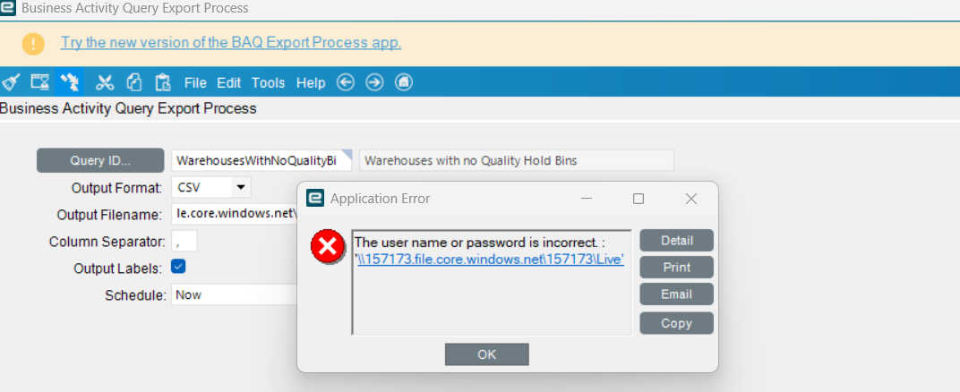

To add joy to the announcement I tried the new AZ share folder using BAQ Export screen.
It does -not- work it gives an error message requesting a user name or password.
There is no spot for this.
Similar results in the Kinetic form but even less helpful. Just gives a something went wrong error.
Unless Microsoft changed it - Azure File Share doesn’t allow anonymous write access. The only anonymous access that’s configurable is read. So not sure the BAQ export process is going to be able to write to that. There’s no way to provide creds in that export process.
I have a BAQ that exports a file to our azure share. IIRC I think support had to run this on our app server (we’re SaaS) so the app server would be logged in.
I also don’t write to the IP it’s: \\ausdt*****\SiteID...*
That makes more sense. They have to add the storage key or Azure RBAC creds somewhere. @tpynepeak probably need to open a ticket and get them to add those creds wherever they need to be entered by Epicor support.
This is great advice, thank you! I have a call with them today.
That being said Epicor opened the case for the FTP transition to Azure when they gave us the 15 days notice.
So why they did not do that then I have no idea.

Turns out they had to set up the Bartender Pipeline on their end.
Once they did I could write to the folder from functions and also update the report location to point to it in Report Styles - before it would error out if we tried to use that location. (Nice quick test - it will tell you right in styles)
