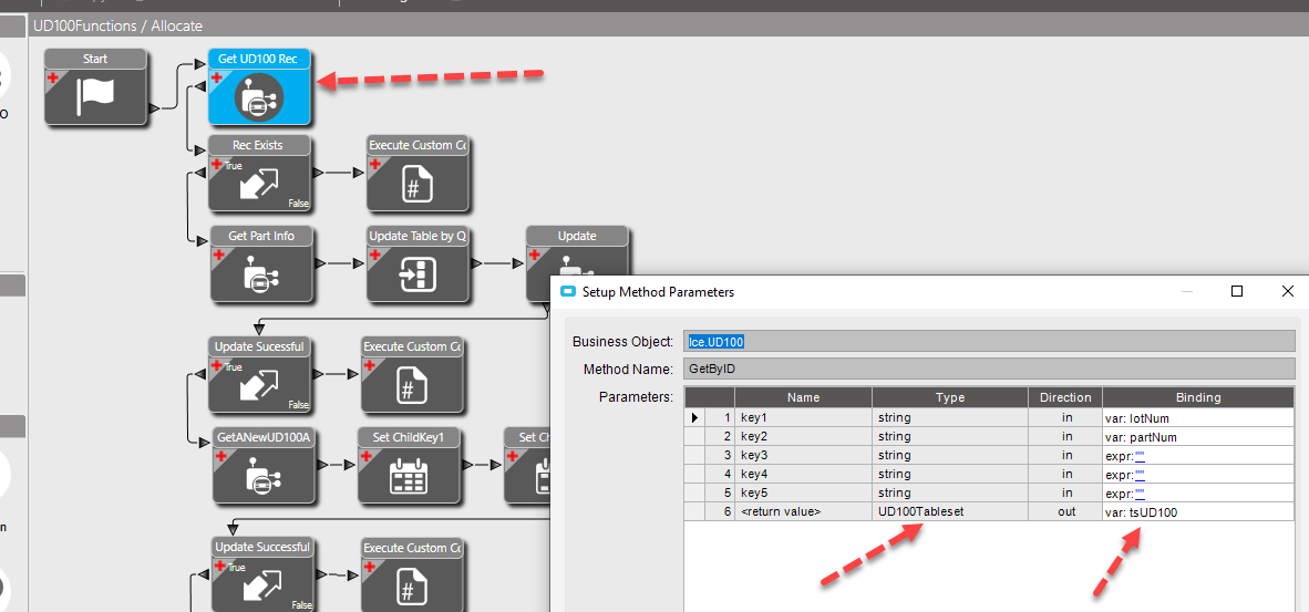

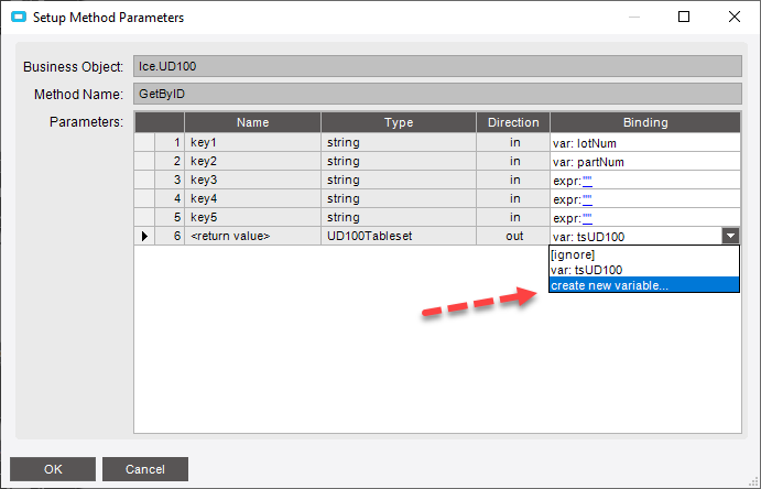

When you invoke a BO, you have the option to set the output to a local variable, which is what I think you’re needing. This will be of the tableset data type associated with that BO

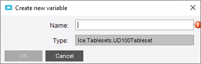

If you don’t already have a local variable, it gives you the option to create it here:
Then, this local variable is acted on through the life of the BPM execution. For example, I invoked Get By ID with my BO execute node, then I have a conditional block to look at the value of the local tsUD100 variable

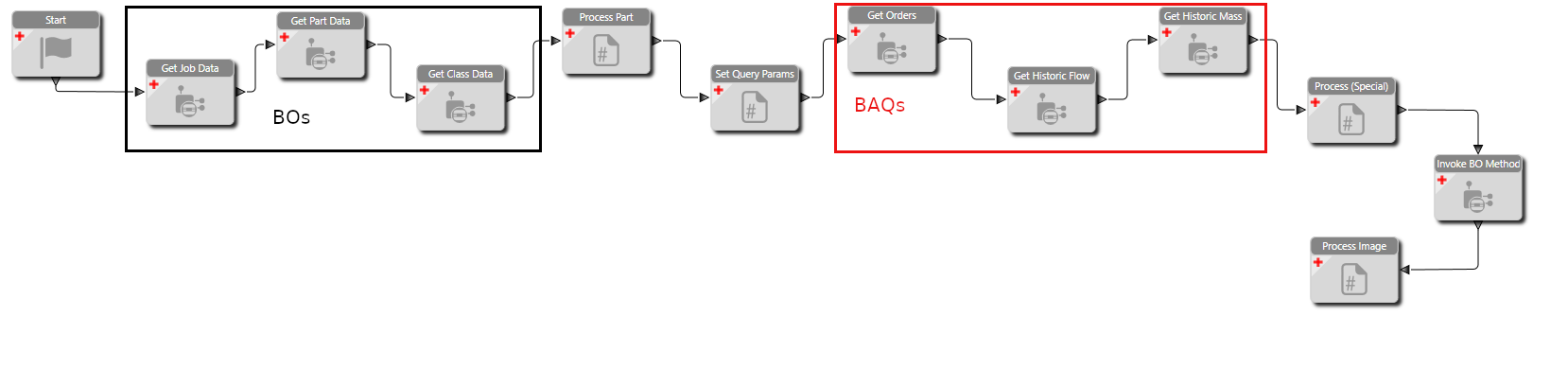

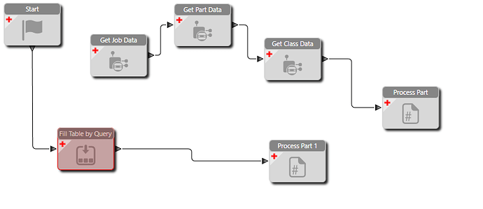

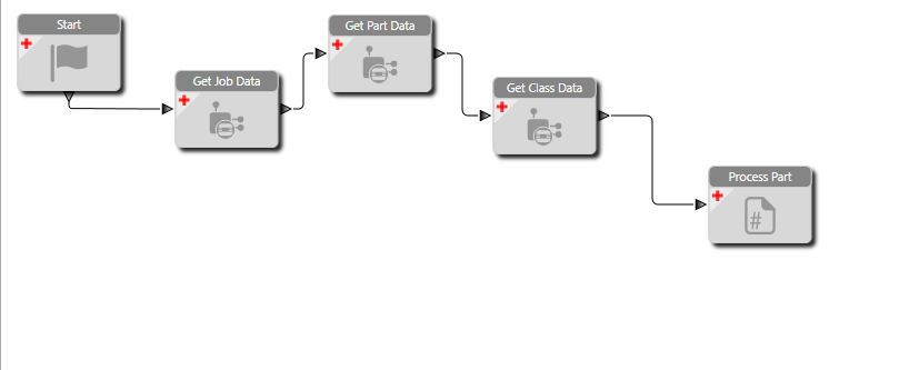

So in my first attempt at this, I did invoke the BO’s directly. This worked and my flow looked as below:
Each BO method calls .GetByID and stores the data to the appropriate Tableset created just as you showed in your post. However, when I run just the flow above, the execution time (via the REST API) is about 10 seconds (the custom code block is only a few lines, mostly setting the outputs). This is about half of the full function and the full function runs in 18 seconds. This function is being accessed by an automated system (a packaging system, loads info to be printed on a sealed bag), and the 20s load time slows down the cycle (one system packages a variety of product). My attempts with the “set table by query” block was driven by a hope that it would reduce the time. Maybe I was attempting to misuse that block.

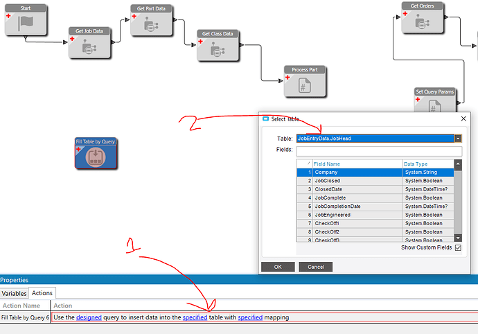

Regarding the original topic, This is the interface I get when trying to use the “Fill table By Query” block.
When I click (1) the “Select Table” dialog pops up. My desire was to be able to “create a variable” for the drop-down (2). Currently, the drop down is populated by the variables I made for that first flow, but a variable of type “DataSet” (created in the Variables tab) is not present. There is also no option to create a new table as with the Invoke BO Method blocks.
