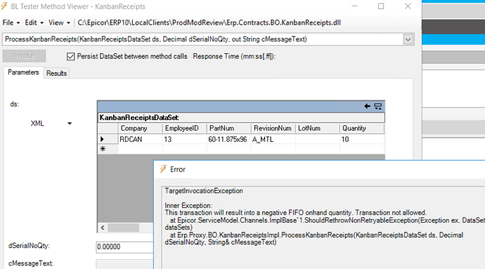

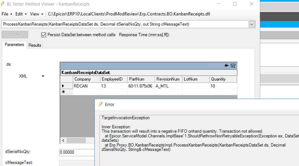

When you try to Kanban receipt using the Kanban Receipt application, if a part material is FIFO and out of stock, the application refuses the Kanban receipt and warns you
The same thing happens if you use the BL Tester to run the KanbanReceipt business object based on tracing the Kanban Receipt app. As expected:
