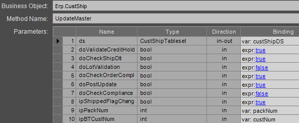

This is what I’m populating:
It succeeds when I set “doCheckShipDtl” to false, but I’ll need to update the ShipDtl records as well.

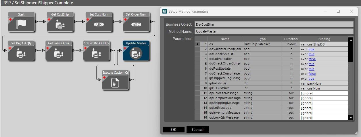

Here’s my function overview:

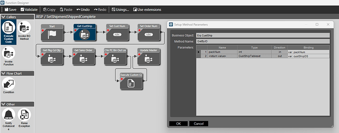

I’m grabbing the custShipDS using GetById.
I also implemented this custom code:

Posting the final solution, because I know it’s a bit of a process to find all the right answers to get UpdateMaster working:
Problem: I am trying to programmatically activate the “Shipped” checkbox in Customer Shipment Entry using Epicor Functions.
Here is my function (I think you might only need GetById, custom code, and UpdateMaster):
Required Methods:
Get Custship → Erp.CustShip.GetByID
Code:
var shipHeadEntry = BufferCopy.Copy<Erp.Tablesets.ShipHeadRow>(custShipDS.ShipHead[0]);
shipHeadEntry.ReadyToInvoice = true;
shipHeadEntry.RowMod = "U";
custShipDS.ShipHead.Add(shipHeadEntry);
