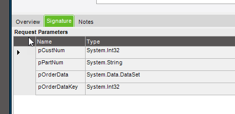

I created an Epic Function library which contains multiples functions. I have a weird issue with one of my function. The function have 4 IN parameters and 2 OUT parameters:
When I click on the “Check Syntax” button, the message “Syntax is OK” showed up.

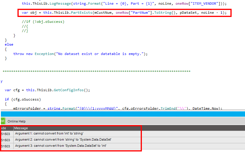

In another function, when I try to call my initial function with the following parameters:
var obj = this.ThisLib.InitialFunc(myInt, myString, myDataSet, myInt2);
When I click on the “Check Syntax” button, I received an error message:
Argument 1: cannot convert from ‘int’ to ‘string’
Argument 2: cannot convert from ‘string’ to ‘System.Data.DataSet’
Argumant 3: cannot convert from ‘System.Data.DataSet’ to ‘int’
Without seeing anything else, I would make the guess that your parameters are in the wrong order. Confirm that your function call and the function definition line up, int to int, string to string, in the same positions. And make sure there are four of each, though that should be a different error message.
This may not be related but when I call a function from another function in 10.2.600 (so feel free to disregard/correct me if Kinetic 21 uses different syntax), I use the code
which makes me think you might be attempting to reference a method within the same function library as you’re calling from. In that case, it might be looking at the request signature of a totally different thing than you’re intending to target
I’m calling my function inside my library, not from a BPM. Actually, I have multiple functions in my library calling each other without any problem except for this one.
The signature of the function is exactly the I call called my function. I included screenshots in my previous email. Maybe I’m missing something lolll
I’m not saying this is the case here. I’ve had issues in the past where after I started developing I add a parameter to a function. After that point I get errors like this. I’ve never figured out exactly how to trigger it to report it to support.
