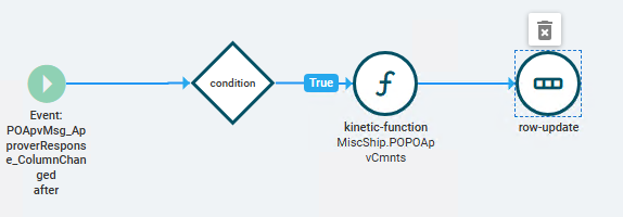

How to append the correct value on a combo change? I am getting duplicate values every time the combo changes in Epicor Kinetic Application studio. The following output is being generated repeatedly.

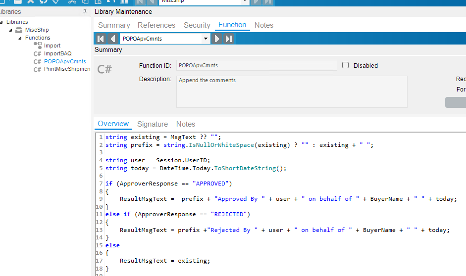

function return : “{actionResult.ResultMsgText}”
Function Code
string existing = MsgText ?? "";
string prefix = string.IsNullOrWhiteSpace(existing) ? "" : existing + " ";
string user = Session.UserID;
string today = DateTime.Today.ToShortDateString();
if (ApproverResponse == "APPROVED")
    ResultMsgText =  prefix + "Approved By " + user + " on behalf of " + BuyerName + " " + today;
else if (ApproverResponse == "REJECTED")
    ResultMsgText = prefix +"Rejected By " + user + " on behalf of " + BuyerName + " " + today;
else
    ResultMsgText = existing;

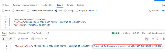

Function tested in Postman

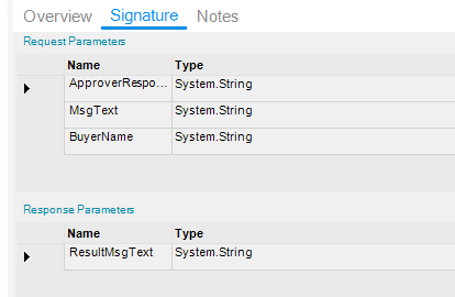

Can you show the properties for the function widget?
It is a code function
No, this guy - how is it set up?
If you have the network up in browser debugging is your function being called multiple times?

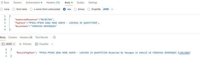

I tested it in Postman, and it also shows the correct value in the popup function, but the control is causing an issue—it is not clearing the existing values
postman test
you are using replace and not merge right?
Your function is set up to append, change line 2 from a space to a newline:
Old: string prefix = string.IsNullOrWhiteSpace(existing) ? "" : existing + " ";
New: string prefix = string.IsNullOrWhiteSpace(existing) ? "" : existing + Environment.NewLine;
But then, it also looks like the function is getting called more than once or something, as you are getting multiple lines appended for one click.
