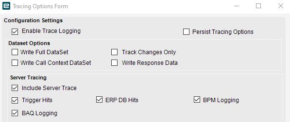

Did you enable server side trace on this? (Can’t see trace on phone)
Ok, good to know, and yes. These are the settings I selected for trace:

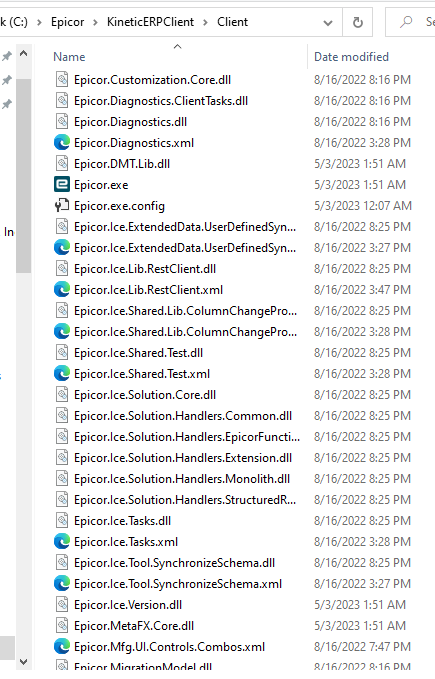

That is milliseconds… This means the server is responding in time, the issue appears to be the client computer… How is your client setup? Is it installed on your PC, or do you connect through a terminal server session?
I believe the client is installed on the local computer. We have an Epicor directory in our C drive, with what appears to be the full client install.

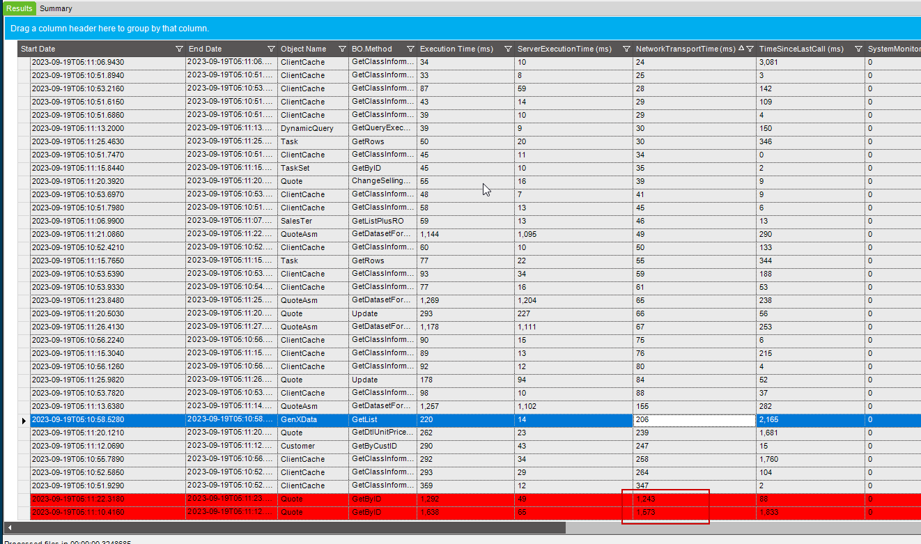

Can you drop that trace in the performance and diagnostic tool? What do you see when you do that
I tried but you modified the file so its not valid any longer. The stuff you redacted is just username and machine name I’m not sure that’s sensitive. But it makes the diagnostics tool blow up any chance you can get us a full clean (unedited) trace?
Oh, sorry, here’s the unmodified version. I’ll run the P&D tool and send the results shortly.
TraceData33964.txt (128.5 KB)
Looks like you are having quite the delay on the network transport. How big is this quote (how many lines etc)? Still only a second though…
