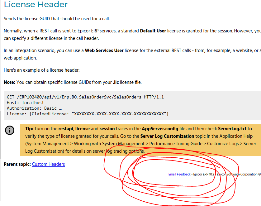

Working on an integration where I need to pass in a specific license and I couldn’t find all the license types, so I did some reflecting and created this basic static class.
@Staci_Stahr_Cummings is this documented anywhere? I couldn’t find it if we want to use a special license CRM, Web Service etc with our integration point we need to know the license type GUID to use it.

This is needed as I stated to pass in the License Header
