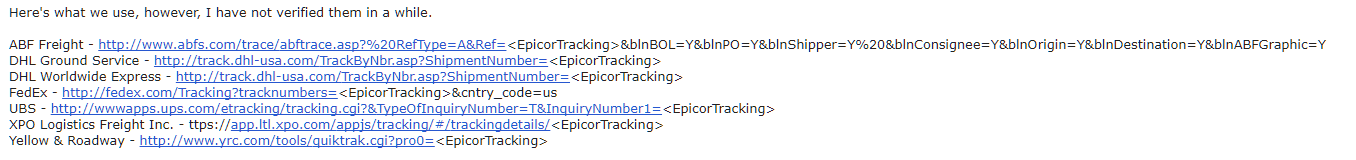

Here’s what we use, however, I have not verified them in a while.
ABF Freight - Shipment Tracking | ArcBest
&blnBOL=Y&blnPO=Y&blnShipper=Y%20&blnConsignee=Y&blnOrigin=Y&blnDestination=Y&blnABFGraphic=Y
DHL Ground Service - http://track.dhl-usa.com/TrackByNbr.asp?ShipmentNumber=
DHL Worldwide Express -
FedEx - FedEx | System Down
&cntry_code=us
UBS -
Tracking | UPS - United States
XPO Logistics Freight Inc. - ttps://
app.ltl.xpo.com/appjs/tracking/#/trackingdetails/
Yellow & Roadway - my.yrc.com: Shipping Tracking | Shipment Tracking | YRC

I thought it was something with my browser, but it seems that if you put an entry in <> it becomes secret code. See the graphic below.
I assume Norman has the in each url, but they are not shown.
Greg
Wow, I didn’t know that… But you are correct, here’s a screenshot.
